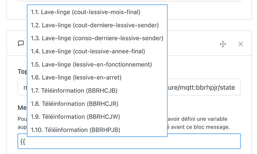

I have a scene that has 12 Get state in a single action.
In the following action block, I want to send 12 MQTT messages but I only see only the last 10 variables:
I don’t know since which release it stopped working because everything was OK when I created the scene (all 12 were visible).

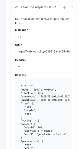

I can’t reproduce it; on my side if I retrieve lots of variables via an « HTTP Request » action for example:
Then I have all the variables:
There’s a small scroll bar, and if I use the up/down arrows I can navigate the list — don’t you have that on your side?
So it’s not the same thing because I also retrieve all the variables when I make an HTTP request and I want to get one of the variables.
In my case I do more than 10 Retrieve last state and then I want to Send an MQTT message and that’s where it gets stuck at 10 — no scrollbar for scrolling, and when I « press the down arrow » it goes back to 1 after 10.
I tested duplicating the scene just in case but I have the same behavior.
Ok thanks, I can reproduce it and I understand what’s wrong :slight_smile: I’ll fix it!
