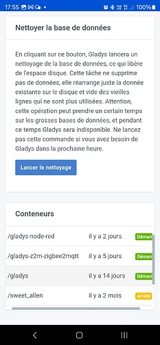

Should I restart Gladys?
I’ve already cleaned the database.
No no, to see your last
I ran a docker ps, and it’s true that Gladys restarted 7 hours ago,
First, try running the command over SSH or directly from the command line. Check when Gladys last restarted.
I just did it and it’s true Gladys restarted 7 hours ago.
Ok so that’s the reason!! ^^
Now, why, that’s another question ^^

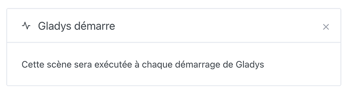

For info, you can create a scene in Gladys that will run when Gladys starts:
If you set the action to send you a Telegram message, at least you’ll know when Gladys restarts :wink:
