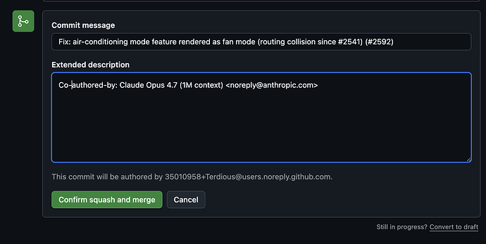

[Regression v4.79.0] Air conditioners display fan speed control instead of AC mode
Hi @pierre-gilles :waving_hand:
While working on Tuya air conditioner support (Tuya - Air Conditioner support - PR9 by Terdious · Pull Request #2591 · GladysAssistant/Gladys · GitHub), I encountered a regression already present in master, unrelated to Tuya.
Since PR #2541 (« Matter: Add fan clusters », released in v4.79.0), all air conditioning devices display fan speed control (Off / Low / Medium / High / Auto) instead of air conditioning mode control (Auto / Cool / Heat / Dehumidification / Ventilation).
Cause: Both AIR_CONDITIONING.MODE and FAN.MODE have the string value 'mode'. As ROW_TYPE_BY_FEATURE_TYPE in DeviceRow.jsx is indexed only by type, the FAN.MODE entry (declared later) silently overwrites AIR_CONDITIONING.MODE → any mode feature is routed to the fan component. This affects all integrations exposing an air-conditioning / mode feature, not just Tuya.
I opened an issue and a PR for the fix (category-aware routing, 1 file):
Feel free to let me know if you want me to adjust the fix approach. Thanks!
Well spotted, thanks for the fix!!
Have you tested both cases in real life to see if it worked well after this fix?
The PR looks good otherwise!
Well, yes and no ^^
I don’t yet have the use case supported by the current version of Gladys, but my test on the ongoing PR works perfectly yes on the fix before / after.
So real test yes, but on a branch not yet implemented in Gladys :wink: :sweat_smile:
Ok, that works for me!
