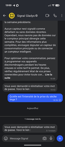

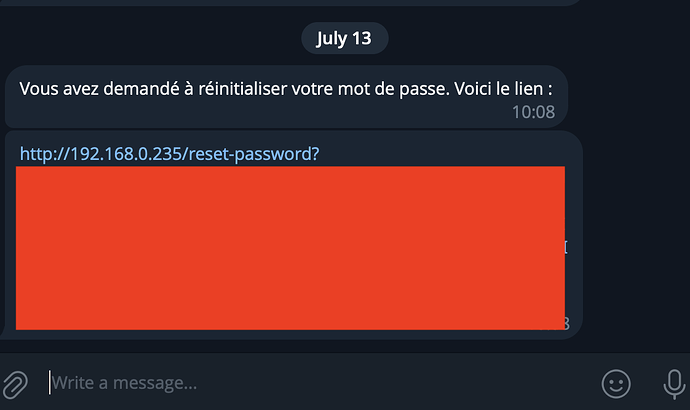

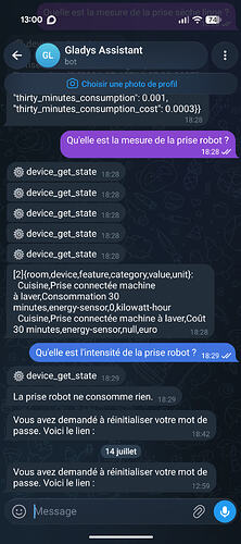

Second unresolved issue: need to reset the password because I can’t log in, except that I do receive a message on Telegram and Signal, but without the reset link.

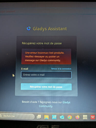

Look Pierre-Gilles, I just tried:
Thanks for your feedback @G_rom0304, which browser are you using? Have you tried another browser?
I’m on Google Chrome and no, I haven’t tried another one.
The problem persists on Telegram and Signal as well.

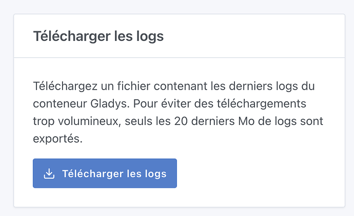

Can you download the logs from Gladys right after an attempt and send them to me privately?
You can do this in one click in « Settings>System » :slight_smile:
Did you receive my message? Or did I send the wrong one :joy:
We misunderstood each other, I’d be happy if you sent me your logs by clicking this button:
And you send me the file in a private message :slight_smile:
Make sure to request a reset just before so that it appears in the logs.
