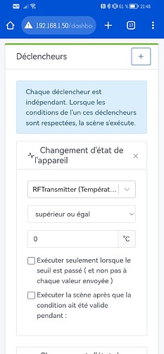

When you put a condition on a sensor, it will always be true…
Example:

As soon as we reset the virtual device to 0, we’ll fall back into the < x condition and restart the scene
Not necessarily, you can check that it’s < 4 AND different from zero
Right now I don’t see how to do an « and » in the triggers :thinking:
I can’t make conditions like counter != 0
Because when it gets reset to 0 I won’t enter this scene anymore
