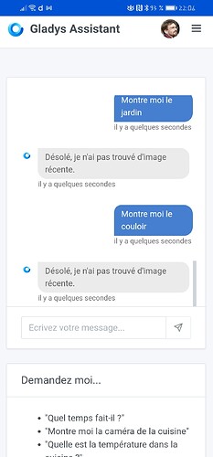

I also have an issue on the chatbox when I ask it to display the camera, but I think I have some logs

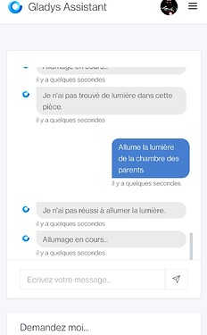

In fact, the dashboard is fine but the chat thread returns:
USB cameras on OrangePi and camerapi on pizero and rpi2

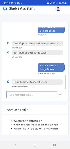

Following the log of @Jean34 and the error mentioning the fr language, I still did the test by switching my account to English… same issue:
Ok so there is a chat problem but the camera integration works.
@Lokkye could this not come from your PR on the chat?
I’m talking about this one =>
After investigation, there is indeed a bug. Since the update of node-nlp in the PR above, retrieving camera images in a PR no longer works.

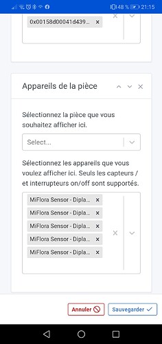

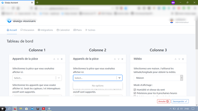

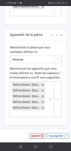

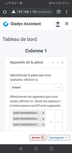

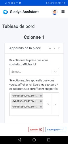

I have a problem with the dashboard editing with my Zigbee and MQTT devices, the rooms are not displayed in the list, in fact there is nothing at all:
Locally
On Gladys +
Locally
On Gladys +
On PC it’s the same and I don’t have any errors in the Firefox console, same for the Docker logs
@Jean34 weird I can’t reproduce it works for me
I think we had a small bug a few weeks ago on this part (on Gladys as well as on Gladys Plus) and I wonder if you might still have the bug because of cache on this part.. if you go to private browsing, or if you clear your browser cache, do you still have the bug?
Otherwise, if it’s not that, how many rooms are in your house?
In 4.2.3 I didn’t have this issue, and of course I ran CCleaner before posting my message. And it happens to me both on PC and smartphone.
