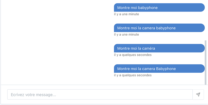

I again have a problem when I ask Gladys to send me an image from the cam via Telegram.
The difference is that this time I have no response in the chat:
with this nice error:

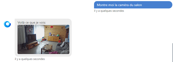

It works in French too
So your error is strange, it may sound silly, but have you tried restarting Gladys?

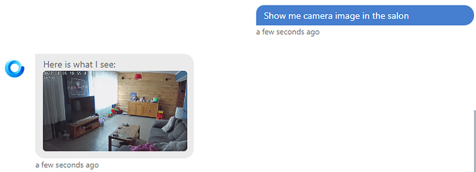

@spenceur you need to ask by room, not by the camera’s name! How would you ask that in French?
However, the error you’re getting is due to another error — a French translation of the response is missing in case of an error ^^
Show me the camera in bedroom xyz
xyz is to be replaced with my child’s name.
For that, it doesn’t work either..
However, I do get an image when I write:
Show me the camera bedroom xyz
Which is ugly
You can add a sentence here Gladys/server/config/brain/camera/questions.fr.json at master · GladysAssistant/Gladys · GitHub
Like \"Show me the camera in the %room%\"
