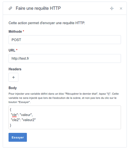

Hi, is this what you want?

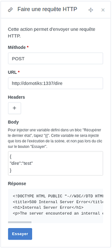

Here’s what I do for the « POST » action:

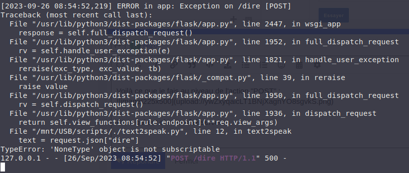

And what is received on the server side:
It seems that the content sent in the body isn’t arriving?

What if you add a header like with curl?
Click the + below Headers,
Well, as mentioned above, I can only thank you again @Hizo :+1: Gladys can now converse with the users present at home! I’ll start sending emails right away :innocent:
