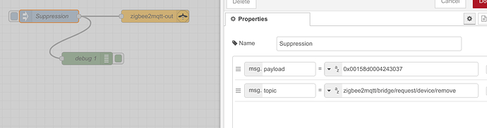

I read HERE that to remove a device from z2m, you have to do it with an MQTT command, with a topic and a payload. I don’t understand much of it but I’ve already seen these things in Node-RED… so I tried — in vain — to do this:
Does anyone know where I’m going wrong? I have the impression that this device also has the annoying tendency to slow down my setup a bit. I’d like to get rid of it properly, and possibly then re-pair it to see if it behaves the same way.
