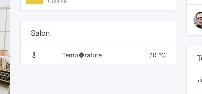

Well, it’s not as simple as that, my change breaks the encoding of special characters (accent, emoji, etc..)
I continue the investigation
The old-fashioned way :slight_smile: é
Actually, I found that to go through the browser’s « TextDecoder Â» API, you must go through the « TextEncoder Â» API to have consistent content! At the same time, it makes sense :slight_smile: I did tests with special characters (accents / emojis) and it works.
