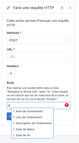

However, it says that you must retrieve the information in a block preceding the « message » block. Yet I can only retrieve information from a device, and not from a calendar. Also, will this information be usable in the HTTP block as well?
Would anyone have an idea on how to proceed?

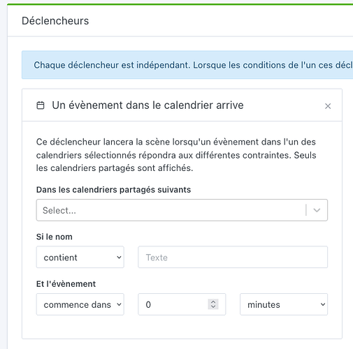

You need to use the trigger « A calendar event is starting »
Then you have access to the event variables in the following actions (using {{ )
@cicoub13 My mistake was not putting a space after the two opening curly braces, thanks to you :+1:
