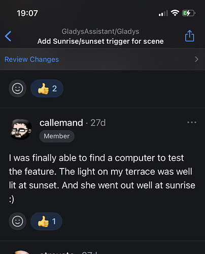

The sunset sunrise triggers don’t work for me, has anyone tested them in real life?
Normally @AlexTrovato had tested I think!
Doesn’t it work at all?

 my bad it was the PR author who tested in real:

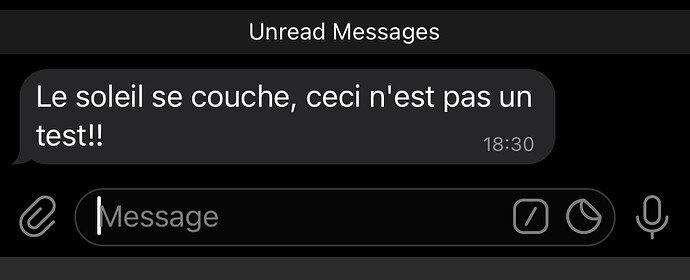

I have the sunset that will soon rotate at my place. Tomorrow morning I will test the sunrise.
In any case, the logs seem to confirm that it is fixed (I added more verbose logs):
Sunset ok!
See you tomorrow for sunrise :slight_smile:
