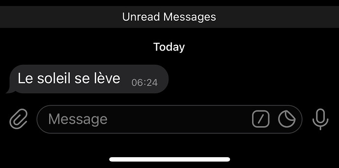

Good night then :grin:
Validated for sunrise!
And at your place?
Yes, it’s good on my end

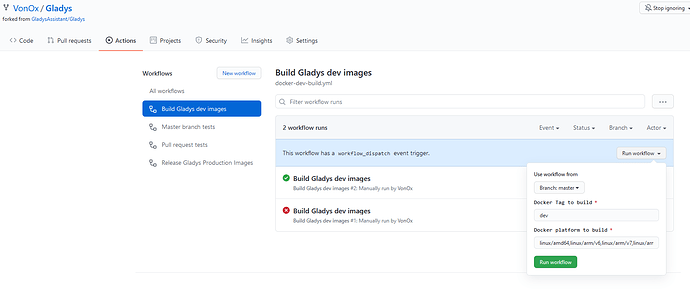

The GitHub CI is designed to build a special branch (on demand)
You just need to define your secrets on your fork
On the Raspberry Pi, it will take too long
The Dockerfile is designed for docker buildx in multi-stage.
