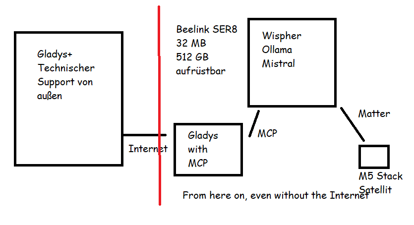

I’ve made some progress and now have the planned structure ready. I’d like to present it here for discussion:
Requirements:
a.) Gladys+ for external technical support access
b.) Gladys Assistant locally with activated MCP server service (local, no Google, no Amazon, or similar. No one needs to know what the person orders, for example, in terms of medication or who they contact…)
c.) A « Cube » for local AI
d.) One M5 Stack per room (small ESP32 computers with microphone and speaker)
e.) Uninterruptible power supply for router, Gladys, and Cube, cost-effective to implement
The process:
Example: A person falls out of their wheelchair and needs immediate help. They speak the wake word to the M5 Stack.
The M5 Stack forwards the message (planned Matter over Thread, which I can program myself) or via ESP Home to the Cube.
On the Cube, the spoken message is recorded and made readable for the AI (planned local Mistral AI). The AI decides: I can answer this myself and does so, or it says that this needs to go to Gladys Assistant and sends the info to Gladys Assistant. Gladys Assistant receives the message via MCP and starts the corresponding scene.
For processing in the scene, there are then numerous integrations. I find the current development by @Lokkye very good for this, as a smartphone can then be reached via this.
Result: Everything local, cost-effective, upgradeable, remotely maintainable, no data evaluation or data storage outside of their local network.
What are your thoughts on this project? I’d be happy to hear reactions, tips, suggestions for improvement, etc.
Best regards
Tom
