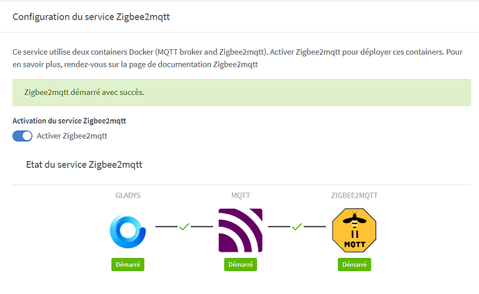

  • reactivating the Zigbee2MQTT service :white_check_mark:
  • testing the Zigbee2MQTT service :no_entry:
On the first start of the Zigbee2MQTT service, I got the following error

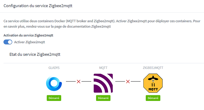

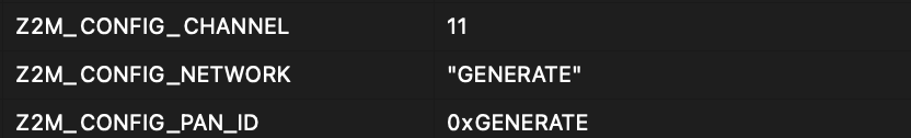

I restarted it and it worked. But the data in the database is weird
If I delete everything and restore a backup, the file configuration.yaml contains
advanced:
  # Optional: ZigBee pan ID (default: shown below)
  # Setting pan_id: GENERATE will make Zigbee2MQTT generate a new panID on next startup
  pan_id: 0xGENERATE
  # Optional: ZigBee channel, changing requires re-pairing of all devices. (Note: use a ZLL channel: 11, 15, 20, or 25 to avoid Problems)
  # (default: 11)
  channel: 11
  # Optional: network encryption key, will improve security
  # Note: changing requires repairing of all devices (default: shown below)
  network_key: GENERATE
Everything appears as if nothing had happened
except that… No reaction from the connected device

:warning: now you have the configuration variables stored in the DB, I advise you to delete them before the next test with the fixes: Z2M_CONFIG_NETWORK Z2M_CONFIG_CHANNEL Z2M_CONFIG_PAN_ID
For information, GENERATED is the default value of z2m, so at startup, GENERATED will be replaced by a real value (I therefore have to retrieve the values after the container starts).
I therefore recommend either deleting the Gladys variables, or starting from a fresh DB.
New image atrovato/gladys:zigbee2mqtt is being built (available in about 1h30), remember to remove both the container AND the image already downloaded from the Gladys test version before testing again.
Thanks everyone.
Starting with a clean image.
Installing the latest image
Configuring the z2m device
Removing containers and z2m folders
Restarting
Failure.

2022-07-31T18:21:15+0200 <info> index.js:21 (Object.start) Starting example service
2022-07-31T18:21:15+0200 <info> index.js:14 (Object.start) starting GoogleActions service
2022-07-31T18:21:15+0200 <info> init.js:31 (Zigbee2mqttManager.init) Zigbee2mqtt USB dongle not attached
2022-07-31T18:21:15+0200 <info> index.js:18 (Object.start) Starting TP-Link service
2022-07-31T18:21:15+0200 <info> index.js:17 (Object.start) Starting eWeLink service
2022-07-31T18:21:15+0200 <info> service.start.js:40 (Service.start) Service ewelink is not configured, so it was not started.
2022-07-31T18:21:15+0200 <info> index.js:15 (Object.start) Starting Bluetooth service
2022-07-31T18:21:16+0200 <error> index.js:20 (process.<anonymous>) uncaughtException catched: uncaughtException
2022-07-31T18:21:16+0200 <error> index.js:21 (process.<anonymous>) Error: ENODEV, No such device
    at Hci.init (/src/server/services/bluetooth/node_modules/@abandonware/noble/lib/hci-socket/hci.js:100:35)
    at NobleBindings.init (/src/server/services/bluetooth/node_modules/@abandonware/noble/lib/hci-socket/bindings.js:78:13)
    at /src/server/services/bluetooth/node_modules/@abandonware/noble/lib/noble.js:60:24
    at processTicksAndRejections (internal/process/task_queues.js:77:11) {
  errno: 19,
  code: 'ENODEV',
  syscall: 'bind'
2022-07-31T18:21:16+0200 <info> index.js:15 (Object.start) Starting Tasmota service
2022-07-31T18:21:16+0200 <info> index.js:16 (Object.start) Starting zwave service
2022-07-31T18:21:16+0200 <info> service.start.js:40 (Service.start) Service zwave is not configured, so it was not started.
2022-07-31T18:21:16+0200 <info> index.js:14 (Object.start) Starting Xiaomi service
2022-07-31T18:21:16+0200 <info> index.js:13 (Object.start) Starting usb service
2022-07-31T18:21:16+0200 <info> index.js:19 (Object.start) Starting Telegram service
2022-07-31T18:21:16+0200 <info> service.start.js:40 (Service.start) Service telegram is not configured, so it was not started.
2022-07-31T18:21:16+0200 <info> index.js:16 (Object.start) Starting RTSP service
2022-07-31T18:21:16+0200 <info> index.js:18 (Object.start) Starting Philips Hue service
2022-07-31T18:21:17+0200 <info> index.js:16 (Object.start) Starting MQTT service
2022-07-31T18:21:17+0200 <info> updateContainer.js:13 (MqttHandler.updateContainer) MQTT: checking for required changes...2022-07-31T18:21:17+0200 <info> service.start.js:40 (Service.start) Service mqtt is not configured, so it was not started.2022-07-31T18:21:17+0200 <info> device.calculateAggregate.js:38 (DeviceManager.calculateAggregate) Calculating aggregates device feature state for interval hourly
2022-07-31T18:21:17+0200 <info> index.js:63 (Server.<anonymous>) Server listening on port 80
2022-07-31T18:21:24+0200 <info> device.calculateAggregate.js:105 (ChildProcess.<anonymous>) device.calculateAggregate: Finishing processing for interval hourly
2022-07-31T18:21:24+0200 <info> device.calculateAggregate.js:38 (DeviceManager.calculateAggregate) Calculating aggregates device feature state for interval daily
2022-07-31T18:21:32+0200 <info> device.calculateAggregate.js:105 (ChildProcess.<anonymous>) device.calculateAggregate: Finishing processing for interval daily
2022-07-31T18:21:32+0200 <info> device.calculateAggregate.js:38 (DeviceManager.calculateAggregate) Calculating aggregates device feature state for interval monthly
2022-07-31T18:21:39+0200 <info> device.calculateAggregate.js:105 (ChildProcess.<anonymous>) device.calculateAggregate: Finishing processing for interval monthly
2022-07-31T18:22:00+0200 <info> scene.checkCalendarTriggers.js:24 (SceneManager.checkCalendarTriggers) Checking calendar triggers at Sun, 31 Jul 2022 16:22:00 GMT
2022-07-31T18:22:19+0200 <info> scene.dailyUpdate.js:58 () Sunrise today is at 6:9 today, in your timezone = Europe/Paris
2022-07-31T18:22:19+0200 <info> scene.dailyUpdate.js:59 () Sunset today is at 21:29 today, in your timezone = Europe/Paris2022-07-31T18:22:19+0200 <info> scene.dailyUpdate.js:70 () The sun rose this morning. Not scheduling for today.
2022-07-31T18:22:19+0200 <info> scene.dailyUpdate.js:81 () Sunset is scheduled, in 3 hours.
2022-07-31T18:22:59+0200 <info> init.js:38 (Zigbee2mqttManager.init) Zigbee2mqtt USB dongle attached to /dev/ttyUSB0
2022-07-31T18:22:59+0200 <info> installMqttContainer.js:28 (Zigbee2mqttManager.installMqttContainer) MQTT broker is being installed as Docker container...
2022-07-31T18:22:59+0200 <info> installMqttContainer.js:29 (Zigbee2mqttManager.installMqttContainer) Pulling eclipse-mosquitto:2 image...
2022-07-31T18:23:00+0200 <info> scene.checkCalendarTriggers.js:24 (SceneManager.checkCalendarTriggers) Checking calendar triggers at Sun, 31 Jul 2022 16:23:00 GMT
2022-07-31T18:23:04+0200 <info> installMqttContainer.js:33 (Zigbee2mqttManager.installMqttContainer) Preparing broker environment...
2022-07-31T18:23:04+0200 <info> installMqttContainer.js:40 (Zigbee2mqttManager.installMqttContainer) Creating container with data in "/var/lib/gladysassistant" on host...
2022-07-31T18:23:04+0200 <info> installMqttContainer.js:54 (Zigbee2mqttManager.installMqttContainer) MQTT broker is restarting...
2022-07-31T18:23:10+0200 <info> installMqttContainer.js:61 (Zigbee2mqttManager.installMqttContainer) Creating user/pass...2022-07-31T18:23:11+0200 <info> installMqttContainer.js:70 (Zigbee2mqttManager.installMqttContainer) MQTT broker is restarting...
2022-07-31T18:23:17+0200 <info> installMqttContainer.js:74 (Zigbee2mqttManager.installMqttContainer) MQTT broker container successfully started and configured
2022-07-31T18:23:17+0200 <info> installZ2mContainer.js:33 (Zigbee2mqttManager.installZ2mContainer) Zigbee2mqtt is being installed as Docker container...
2022-07-31T18:23:17+0200 <info> installZ2mContainer.js:34 (Zigbee2mqttManager.installZ2mContainer) Pulling koenkk/zigbee2mqtt:latest image...
2022-07-31T18:23:19+0200 <info> installZ2mContainer.js:37 (Zigbee2mqttManager.installZ2mContainer) Configuration of Device /dev/ttyUSB0
2022-07-31T18:23:19+0200 <info> installZ2mContainer.js:42 (Zigbee2mqttManager.installZ2mContainer) Creation of container...
2022-07-31T18:23:19+0200 <info> installZ2mContainer.js:45 (Zigbee2mqttManager.installZ2mContainer) Zigbee2mqtt successfully installed and configured as Docker container
2022-07-31T18:23:19+0200 <info> installZ2mContainer.js:58 (Zigbee2mqttManager.installZ2mContainer) Preparing Zigbee2mqtt environment...
2022-07-31T18:23:19+0200 <info> installZ2mContainer.js:72 (Zigbee2mqttManager.installZ2mContainer) Zigbee2mqtt container is starting...
2022-07-31T18:23:25+0200 <info> installZ2mContainer.js:78 (Zigbee2mqttManager.installZ2mContainer) Zigbee2mqtt container successfully started
2022-07-31T18:23:25+0200 <info> connect.js:14 (Zigbee2mqttManager.connect) Connecting Gladys to mqtt://localhost:1884 MQTT broker...
2022-07-31T18:23:26+0200 <info> connect.js:24 (MqttClient.<anonymous>) Connected to MQTT container mqtt://localhost:1884
2022-07-31T18:23:26+0200 <info> subscribe.js:12 (Zigbee2mqttManager.subscribe) Subscribing to MQTT topic zigbee2mqtt/#
2022-07-31T18:24:00+0200 <info> scene.checkCalendarTriggers.js:24 (SceneManager.checkCalendarTriggers) Checking calendar triggers at Sun, 31 Jul 2022 16:24:00 GMT
2022-07-31T18:25:00+0200 <info> scene.checkCalendarTriggers.js:24 (SceneManager.checkCalendarTriggers) Checking calendar triggers at Sun, 31 Jul 2022 16:25:00 GMT
2022-07-31T18:26:00+0200 <info> scene.checkCalendarTriggers.js:24 (SceneManager.checkCalendarTriggers) Checking calendar triggers at Sun, 31 Jul 2022 16:26:00 GMT
2022-07-31T18:26:28+0200 <warn> handleMqttMessage.js:100 () Zigbee2mqtt device 0x00124b0024c06f1c, feature linkquality not configured in Gladys.
2022-07-31T18:26:29+0200 <warn> handleMqttMessage.js:100 () Zigbee2mqtt device 0x00124b0024c06f1c, feature linkquality not configured in Gladys.
2022-07-31T18:26:30+0200 <warn> handleMqttMessage.js:100 () Zigbee2mqtt device 0x00124b0024c06f1c, feature linkquality not configured in Gladys.
2022-07-31T18:26:31+0200 <warn> handleMqttMessage.js:100 () Zigbee2mqtt device 0x00124b0024c06f1c, feature linkquality not configured in Gladys.
2022-07-31T18:26:32+0200 <warn> handleMqttMessage.js:100 () Zigbee2mqtt device 0x00124b0024c06f1c, feature linkquality not configured in Gladys.
2022-07-31T18:26:33+0200 <warn> handleMqttMessage.js:100 () Zigbee2mqtt device 0x00124b0024c06f1c, feature linkquality not configured in Gladys.
2022-07-31T18:26:34+0200 <warn> handleMqttMessage.js:100 () Zigbee2mqtt device 0x00124b0024c06f1c, feature linkquality not configured in Gladys.
2022-07-31T18:26:35+0200 <warn> handleMqttMessage.js:100 () Zigbee2mqtt device 0x00124b0024c06f1c, feature linkquality not configured in Gladys.
2022-07-31T18:27:00+0200 <info> scene.checkCalendarTriggers.js:24 (SceneManager.checkCalendarTriggers) Checking calendar triggers at Sun, 31 Jul 2022 16:27:00 GMT
2022-07-31T18:27:12+0200 <info> index.js:25 (shutdown) SIGTERM received.
2022-07-31T18:27:12+0200 <info> index.js:31 (shutdown) Closing database connection.
> gladys-server@ start:prod /src/server
> cross-env NODE_ENV=production node index.js
2022-07-31T18:30:51+0200 <info> job.purge.js:17 (Job.purge) Deleting all background jobs created before = Sun Jul 24 2022 18:30:51 GMT+0200 (Central European Summer Time)
Initialising OpenZWave 1.6.0 binary addon for Node.JS.
        OpenZWave Security API is ENABLED
        ZWave device db    : /usr/local/etc/openzwave
        User settings path : /src/server/services/zwave/node_modules/openzwave-shared/build/Release/../../
        Option Overrides : --Logging false --ConsoleOutput false --SaveConfiguration true
2022-07-31T18:30:58+0200 <info> index.js:14 (Object.start) starting Alexa service
2022-07-31T18:30:58+0200 <info> index.js:16 (Object.start) Starting RTSP service
2022-07-31T18:30:58+0200 <info> index.js:13 (Object.start) Starting usb service
2022-07-31T18:30:58+0200 <info> index.js:19 (Object.start) Starting Telegram service
2022-07-31T18:30:58+0200 <info> service.start.js:40 (Service.start) Service telegram is not configured, so it was not started.
2022-07-31T18:30:58+0200 <info> index.js:14 (Object.start) starting GoogleActions service
2022-07-31T18:30:59+0200 <info> init.js:38 (Zigbee2mqttManager.init) Zigbee2mqtt USB dongle attached to /dev/ttyUSB0
2022-07-31T18:30:59+0200 <info> installMqttContainer.js:28 (Zigbee2mqttManager.installMqttContainer) MQTT broker is being installed as Docker container...
2022-07-31T18:30:59+0200 <info> installMqttContainer.js:29 (Zigbee2mqttManager.installMqttContainer) Pulling eclipse-mosquitto:2 image...
2022-07-31T18:31:01+0200 <info> installMqttContainer.js:33 (Zigbee2mqttManager.installMqttContainer) Preparing broker environment...
2022-07-31T18:31:01+0200 <info> installMqttContainer.js:40 (Zigbee2mqttManager.installMqttContainer) Creating container with data in "/var/lib/gladysassistant" on host...
2022-07-31T18:31:01+0200 <info> installMqttContainer.js:54 (Zigbee2mqttManager.installMqttContainer) MQTT broker is restarting...
2022-07-31T18:31:07+0200 <info> installMqttContainer.js:61 (Zigbee2mqttManager.installMqttContainer) Creating user/pass...2022-07-31T18:31:08+0200 <info> installMqttContainer.js:70 (Zigbee2mqttManager.installMqttContainer) MQTT broker is restarting...
2022-07-31T18:31:14+0200 <info> installMqttContainer.js:74 (Zigbee2mqttManager.installMqttContainer) MQTT broker container successfully started and configured
2022-07-31T18:31:14+0200 <info> installZ2mContainer.js:33 (Zigbee2mqttManager.installZ2mContainer) Zigbee2mqtt is being installed as Docker container...
2022-07-31T18:31:14+0200 <info> installZ2mContainer.js:34 (Zigbee2mqttManager.installZ2mContainer) Pulling koenkk/zigbee2mqtt:latest image...
2022-07-31T18:31:16+0200 <info> installZ2mContainer.js:37 (Zigbee2mqttManager.installZ2mContainer) Configuration of Device /dev/ttyUSB0
2022-07-31T18:31:16+0200 <info> installZ2mContainer.js:42 (Zigbee2mqttManager.installZ2mContainer) Creation of container...
2022-07-31T18:31:16+0200 <info> installZ2mContainer.js:45 (Zigbee2mqttManager.installZ2mContainer) Zigbee2mqtt successfully installed and configured as Docker container
2022-07-31T18:31:16+0200 <info> installZ2mContainer.js:58 (Zigbee2mqttManager.installZ2mContainer) Preparing Zigbee2mqtt environment...
2022-07-31T18:31:16+0200 <info> installZ2mContainer.js:72 (Zigbee2mqttManager.installZ2mContainer) Zigbee2mqtt container is starting...
2022-07-31T18:31:22+0200 <info> installZ2mContainer.js:78 (Zigbee2mqttManager.installZ2mContainer) Zigbee2mqtt container successfully started
2022-07-31T18:31:22+0200 <info> connect.js:14 (Zigbee2mqttManager.connect) Connecting Gladys to mqtt://localhost:1884 MQTT broker...
2022-07-31T18:31:23+0200 <info> connect.js:24 (MqttClient.<anonymous>) Connected to MQTT container mqtt://localhost:1884
2022-07-31T18:31:23+0200 <info> subscribe.js:12 (Zigbee2mqttManager.subscribe) Subscribing to MQTT topic zigbee2mqtt/#
2022-07-31T18:31:23+0200 <info> index.js:18 (Object.start) Starting TP-Link service
2022-07-31T18:31:23+0200 <info> index.js:17 (Object.start) Starting eWeLink service
2022-07-31T18:31:23+0200 <info> service.start.js:40 (Service.start) Service ewelink is not configured, so it was not started.
2022-07-31T18:31:23+0200 <info> index.js:15 (Object.start) Starting Bluetooth service
2022-07-31T18:31:24+0200 <error> index.js:20 (process.<anonymous>) uncaughtException catched: uncaughtException
2022-07-31T18:31:24+0200 <error> index.js:21 (process.<anonymous>) Error: ENODEV, No such device
  errno: 19,
  code: 'ENODEV',
  syscall: 'bind'
2022-07-31T18:31:24+0200 <info> index.js:15 (Object.start) Starting Tasmota service
2022-07-31T18:31:24+0200 <info> index.js:16 (Object.start) Starting zwave service
2022-07-31T18:31:24+0200 <info> service.start.js:40 (Service.start) Service zwave is not configured, so it was not started.
2022-07-31T18:31:24+0200 <info> index.js:14 (Object.start) Starting Xiaomi service
2022-07-31T18:31:24+0200 <info> index.js:20 (Object.start) Starting Open Weather service
2022-07-31T18:31:24+0200 <info> service.start.js:40 (Service.start) Service openweather is not configured, so it was not started.
2022-07-31T18:31:24+0200 <info> index.js:18 (Object.start) Starting Philips Hue service
2022-07-31T18:31:25+0200 <info> index.js:16 (Object.start) Starting MQTT service
2022-07-31T18:31:25+0200 <info> updateContainer.js:13 (MqttHandler.updateContainer) MQTT: checking for required changes...2022-07-31T18:31:25+0200 <info> service.start.js:40 (Service.start) Service mqtt is not configured, so it was not started.2022-07-31T18:31:25+0200 <info> index.js:64 (Object.start) Starting CalDAV service
2022-07-31T18:31:25+0200 <info> index.js:21 (Object.start) Starting example service
2022-07-31T18:31:25+0200 <info> scene.dailyUpdate.js:58 () Sunrise today is at 6:9 today, in your timezone = Europe/Paris
2022-07-31T18:31:25+0200 <info> scene.dailyUpdate.js:59 () Sunset today is at 21:29 today, in your timezone = Europe/Paris2022-07-31T18:31:25+0200 <info> scene.dailyUpdate.js:70 () The sun rose this morning. Not scheduling for today.
2022-07-31T18:31:25+0200 <info> scene.dailyUpdate.js:81 () Sunset is scheduled, in 3 hours.
2022-07-31T18:31:25+0200 <info> device.calculateAggregate.js:38 (DeviceManager.calculateAggregate) Calculating aggregates device feature state for interval hourly
2022-07-31T18:31:26+0200 <info> index.js:63 (Server.<anonymous>) Server listening on port 80
2022-07-31T18:31:34+0200 <info> device.calculateAggregate.js:105 (ChildProcess.<anonymous>) device.calculateAggregate: Finishing processing for interval hourly
2022-07-31T18:31:34+0200 <info> device.calculateAggregate.js:38 (DeviceManager.calculateAggregate) Calculating aggregates device feature state for interval daily
2022-07-31T18:31:43+0200 <info> device.calculateAggregate.js:105 (ChildProcess.<anonymous>) device.calculateAggregate: Finishing processing for interval daily
2022-07-31T18:31:44+0200 <info> device.calculateAggregate.js:38 (DeviceManager.calculateAggregate) Calculating aggregates device feature state for interval monthly
2022-07-31T18:31:52+0200 <info> device.calculateAggregate.js:105 (ChildProcess.<anonymous>) device.calculateAggregate: Finishing processing for interval monthly
2022-07-31T18:32:00+0200 <info> scene.checkCalendarTriggers.js:24 (SceneManager.checkCalendarTriggers) Checking calendar triggers at Sun, 31 Jul 2022 16:32:00 GMT
2022-07-31T18:32:19+0200 <warn> scene.executeActions.js:37 (executeAction) BadParameters [Error]: Zigbee2mqtt expose not found: "zigbee2mqtt:0x00124b0024c06f1c:switch:binary:state" with property "state"
    at Zigbee2mqttManager.setValue (/src/server/services/zigbee2mqtt/lib/setValue.js:38:11)
    at DeviceManager.setValue (/src/server/lib/device/device.setValue.js:21:24)
    at Object.device.set-value (/src/server/lib/scene/scene.actions.js:30:24)
    at executeAction (/src/server/lib/scene/scene.executeActions.js:32:35)
    at SceneManager.executeSingleAction (/src/server/lib/scene/scene.executeSingleAction.js:17:11)
    at EventEmitter.<anonymous> (/src/server/utils/functionsWrapper.js:13:13)
    at EventEmitter.emit (events.js:400:28)
    at Event.emit (/src/server/lib/event/index.js:18:16)
2022-07-31T18:32:21+0200 <warn> scene.executeActions.js:37 (executeAction) BadParameters [Error]: Zigbee2mqtt expose not found: "zigbee2mqtt:0x00124b0024c06f1c:switch:binary:state" with property "state"
Z2m :
pi@raspberrypi:~ $ docker logs gladys-z2m-zigbee2mqtt
Using '/app/data' as data directory
            READ THIS CAREFULLY
Refusing to start because configuration is not valid, found the following errors:
- advanced.pan_id: should be number or 'GENERATE' (is '0xGENERATE')
If you don't know how to solve this, read https://www.zigbee2mqtt.io/guide/configuration
            READ THIS CAREFULLY
            READ THIS CAREFULLY
            READ THIS CAREFULLY
            READ THIS CAREFULLY
            READ THIS CAREFULLY
            READ THIS CAREFULLY
            READ THIS CAREFULLY
            READ THIS CAREFULLY
            READ THIS CAREFULLY
Z2m MQTT :
pi@raspberrypi:~ $ docker logs gladys-z2m-mqtt
1659285062: mosquitto version 2.0.14 starting
1659285062: Config loaded from /mosquitto/config/mosquitto.conf.
1659285062: Opening ipv4 listen socket on port 1884.
1659285062: Opening ipv6 listen socket on port 1884.
1659285062: mosquitto version 2.0.14 running
1659285068: mosquitto version 2.0.14 terminating
1659285069: mosquitto version 2.0.14 starting
1659285069: Config loaded from /mosquitto/config/mosquitto.conf.
1659285069: Opening ipv4 listen socket on port 1884.
1659285069: Opening ipv6 listen socket on port 1884.
1659285069: mosquitto version 2.0.14 running
1659285083: New connection from 127.0.0.1:37116 on port 1884.1659285083: New client connected from 127.0.0.1:37116 as gladys-main-instance-113944 (p2, c1, k60, u'gladys').
pi@raspberrypi:~ $
Edit: Readability

Hey hey hello,
I tried another change, I’ll let you try again just like you know how to do :wink:
Don’t forget to properly remove the container and the image from your Docker :slight_smile:
It works!
Logs are coming…

Installation and removal:
pi@Nichoir2:~ $ docker ps -a
CONTAINER ID   IMAGE                 COMMAND                  CREATED       STATUS       PORTS                                                              NAMES
pi@Nichoir2:~ $ ls /var/lib                                  adguard     dhcp       man-db  polkit-1     ucf              alsa        dhcpcd     misc    private      usb_modeswitch   apache2     docker     motion  python       vim              apt         dpkg       nfs     raspberrypi                   containerd  git        pam     sudo                          dbus        logrotate  php     systemd
pi@Nichoir2:~ $ docker run -d --log-driver json-file --log-opt max-size=10m --cgroupns=host --restart=always --privileged --network=host --name gladys -e NODE_ENV=production -e SERVER_PORT=8088 -e TZ=Europe/Paris -e SQLITE_FILE_PATH=/var/lib/gladysassistant/gladys-production.db -v /var/run/docker.sock:/var/run/docker.sock -v /var/lib/gladysassistant:/var/lib/gladysassistant -v /dev:/dev -v /run/udev:/run/udev:ro atrovato/gladys:zigbee2mqtt
Unable to find image 'atrovato/gladys:zigbee2mqtt' locally
zigbee2mqtt: Pulling from atrovato/gladys
c6556b3b6858: Already exists
03a5d5e3efc3: Pull complete
49e084b1c42c: Pull complete
2375b3b7af35: Pull complete
969b14474fbc: Pull complete
f51fe98a8646: Pull complete
ca5405dd3a9c: Pull complete
ff9801df0f01: Pull complete
6830d33b7911: Pull complete
4f4fb700ef54: Pull complete
812d1e8d26b2: Pull complete
846852f36f43: Pull complete
b050eef54dd7: Pull complete
Digest: sha256:4f6ccdfdf75da02ecfd9a55209e9505fde9dee85705bf0aaab65d736a45fb544
Status: Downloaded newer image for atrovato/gladys:zigbee2mqtt
af7ee97862bb5c50867252125da59da869c73800485c421a1bf4c00c9cbeecdf
After, Gladys configuration:
pi@Nichoir2:~ $ docker ps -a                                 CONTAINER ID   IMAGE                         COMMAND                  CREATED         STATUS         PORTS                                                              NAMES
af7ee97862bb   atrovato/gladys:zigbee2mqtt   "docker-entrypoint.s…"   2 minutes ago   Up 2 minutes                                                                      gladys
pi@Nichoir2:~ $ docker ps                                    CONTAINER ID   IMAGE                         COMMAND                  CREATED          STATUS          PORTS                                                              NAMES
03dcc3670763   koenkk/zigbee2mqtt:latest     "docker-entrypoint.s…"   2 minutes ago    Up 2 minutes                                                                       gladys-z2m-zigbee2mqtt
79e88a87cebe   eclipse-mosquitto:2           "/docker-entrypoint.…"   2 minutes ago    Up 2 minutes                                                                       gladys-z2m-mqtt
af7ee97862bb   atrovato/gladys:zigbee2mqtt   "docker-entrypoint.s…"   12 minutes ago   Up 12 minutes                                                                      gladys
Removal, restoration:
pi@Nichoir2:~ $ docker stop gladys
gladys
pi@Nichoir2:~ $ docker stop gladys-z2m-mqtt
gladys-z2m-mqtt
pi@Nichoir2:~ $ docker stop gladys-z2m-zigbee2mqtt
pi@Nichoir2:~ $ docker rm gladys-z2m-zigbee2mqtt
pi@Nichoir2:~ $ docker rm gladys-z2m-mqtt
gladys-z2m-mqtt
af7ee97862bb   atrovato/gladys:zigbee2mqtt   "docker-entrypoint.s…"   15 minutes ago   Exited (0) About a minute ago         gladys
pi@Nichoir2:~ $ docker start gladys
gladys
4c2287d6de77   koenkk/zigbee2mqtt:latest     "docker-entrypoint.s…"   20 seconds ago   Up 17 seconds                                                                          gladys-z2m-zigbee2mqtt
825510b5fb4a   eclipse-mosquitto:2           "/docker-entrypoint.…"   36 seconds ago   Up 26 seconds                                                                          gladys-z2m-mqtt
af7ee97862bb   atrovato/gladys:zigbee2mqtt   "docker-entrypoint.s…"   16 minutes ago   Up About a minute                                                                      gladys
CONTAINER ID   IMAGE                         COMMAND                  CREATED              STATUS              PORTS                                                              NAMES4c2287d6de77   koenkk/zigbee2mqtt:latest     "docker-entrypoint.s…"   About a minute ago   Up About a minute                                                                      gladys-z2m-zigbee2mqtt
825510b5fb4a   eclipse-mosquitto:2           "/docker-entrypoint.…"   About a minute ago   Up About a minute                                                                      gladys-z2m-mqtt
af7ee97862bb   atrovato/gladys:zigbee2mqtt   "docker-entrypoint.s…"   17 minutes ago       Up 2 minutes                                                                           gladys
pi@Nichoir2:~ $
