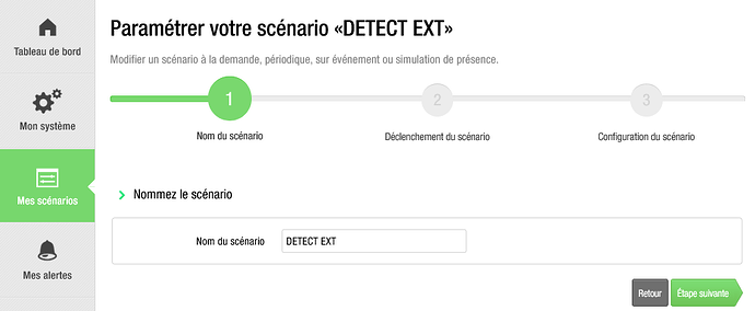

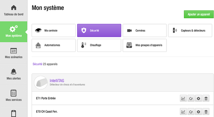

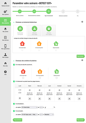

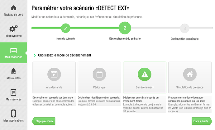

To give an overview of what I currently have with my Myfox HC2 control panel which was bought by Somfy but for which they no longer provide hardware, only maintain the website — so as my devices fail/will fail it’s over (problem notably with smoke detectors which must be replaced every 10 years) I therefore need to turn to another solution. I looked at the main solutions Domoticz, Jeedom, Home Assistant and I must say that by far Gladys is the simplest in terms of setup but for some needs it is also the least powerful because limited in that configuration. Finding the right balance between the two is certainly not the easiest task for developers but Gladys has the advantage of having development that, as much as possible, follows user requests.
To give an example of what I currently have

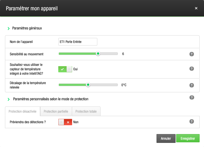

My intrusion sensors
and their settings; they are by default integrated into the alarm system logic but still have detailed configuration
Nice, well-designed but closed system and since it dates from 2013 and is no longer maintained, it may soon be down either on the control panel side or the sensors’ side — hence my turn toward Gladys…

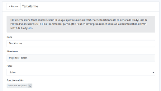

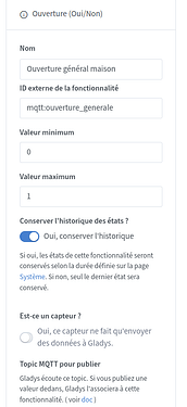

First you need to create an MQTT device
I created a device with the Opening (Yes/No) feature
This is not a sensor because we need to control it from a scene in Gladys.
Next you need to create 2 scenes to control the MQTT device

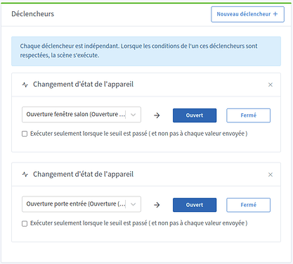

One opening detection scene that will detect the state change of an opening sensor for example. In this case we will set the MQTT device to value 1.
The second scene will detect the state change of a sensor and thus we will set the MQTT device to 0.
You can invert the MQTT device values if you want. This is only an example.
  1. Creating the opening detection scene
ATTENTION: Here I have a bug on the state change trigger. I will put here the real way to do it but it will not work because of the bug. For it to work you will need to invert the open / closed choice.
Here put in the triggers all the sensors you want to test. So if one of the sensors goes to the open state then that means your house is open. For the example I only put 2 sensors.
I did not check the Execute only… box so that each time your Zigbee sensor sends a message the scene will be executed.

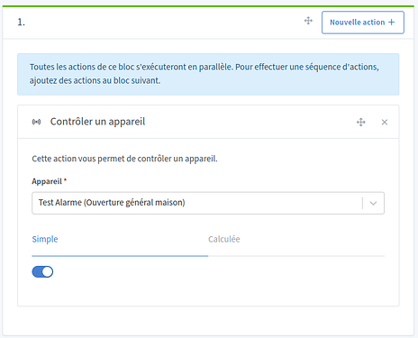

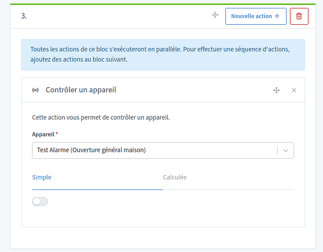

In an action block add the action Control a device and set the switch to state 1 / ON
The scene is finished.

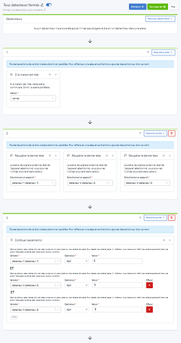

  1. Creating the closing detection scene

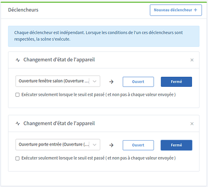

Here put in the triggers all the sensors you want to test. Thus the scene will be executed each time Gladys receives a closed state from one of the sensors. For the example I only put 2 sensors.

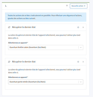

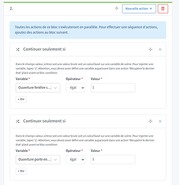

In a first action block we will retrieve the state of all sensors.
Unlike the opening scene, here all sensors must be closed to consider the house closed!

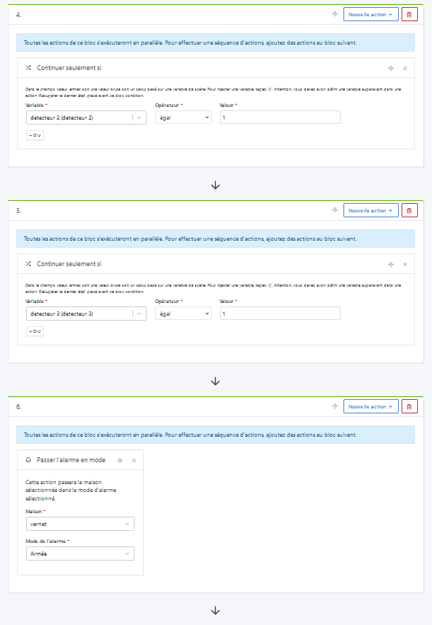

In a second action block, add a Continue only if action for each sensor.
If the value is equal to 1 that means your sensor is closed.
Then in a final block add a Control a device action and set your MQTT device to 0 / OFF
Then you can use your MQTT device in your scenes.

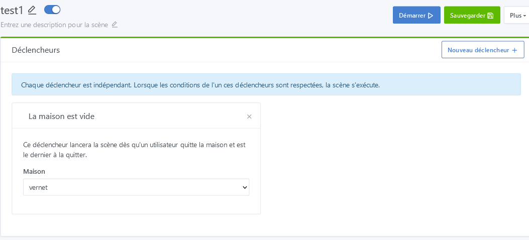

For example make a scene with the trigger Leaving the house.
In a block below retrieve the state of your MQTT device
In another block add a Continue and only if action to check the value is 0 or 1 of your MQTT device
Then add other blocks depending on the purpose of your scene.

But to be honest
  • the 1st one remains simple (test detection of an opening)
  • the 2nd one is devilishly tedious
And I’m surprised by the logic underlying the 2nd; in the first case it’s a change of a state that’s tested, in the 2nd it’s a state of states!
Although since we have the checkbox « execute only… » that allows testing on a change of state

So actually in the triggers area we have
Case 1

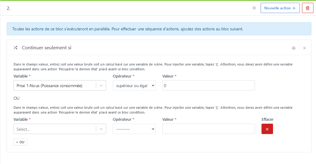

« Each trigger is independent. When the conditions of one of these triggers are met, the scene runs. »
which is suitable to test if at least one of the sensors is open
If we could have had the toggle I suggested
Case 2
« Each trigger is independent. When the conditions of all of these triggers are met, the scene runs. »
which is suitable to test if all the sensors are closed

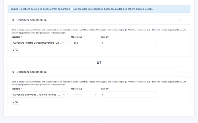

or where we could put the different sensors like below
wouldn’t be bad, right?

Maybe what would be more explicit would be to implement @Tlse-vins’s suggestion (they’re good, the guys from the South ;)), a simple cosmetic change, so that it looks like:
Would it be better like this?

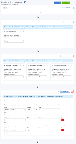

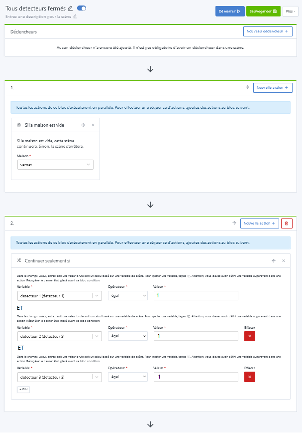

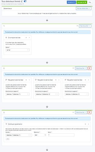

To make myself better understood I made the corresponding scenes :
At least one sensor open
All sensors closed - current version
All sensors closed - version I find simpler
ideal version

So I’ll try to summarize, because in the end we talk a lot about not much :wink:
The version I proposed corresponds to what you suggested as « All sensors closed version that I find simpler ».
It’s just that you need a few extra clicks (not many honestly).
So in the end we’re almost completely on the same page.

So my advice: take the time to really understand what Gladys does, and in what logic it operates, and you’ll see all its potential. Your suggestions to improve it will be all the more relevant :wink: !!
The ideal version you’re proposing you can already do, except that it’s not marked AND. You add three Continue only if actions in the same box and it does what you’re asking, actually.
Totally agree with you (aside from the click, exactly the same thing)
As for the rest, I made a request to meet my need and I was told it’s not possible or you have to do it differently; because that’s frustrating I made other proposals around that might work as a workaround until @_Will_71 suggested a solution that works (thanks again :+1:). So yes, my thinking did evolve depending on the answers given and what I understood along the way with the answers (who said there’s a Macron supporter in the room? :rofl: « Only the Sith are so absolute. » :crazy_face:)
Besides, that’s the purpose of a forum… and sometimes you have to persevere; otherwise I wouldn’t have managed to connect Gladys to my IPX800V5 via Node-RED and control my roller shutters (VR) based on the sun’s position. I found how to do it and shared my experience through mini-tutorials :slight_smile: whereas initially I had made requests to @pierre-gilles (or on the forum in the feature requests, I don’t quite remember) and the answer at the time was that it wasn’t possible. During discussions (because I hadn’t understood that the MQTT syntax isn’t standard) with @pierre-gilles among others, I understood how Gladys worked and thus how to do it via Node-RED. Same for the sun position: I had requested that; I was told it wasn’t possible for now, I worked around it with Node-RED and now I can control the roller shutters in Gladys taking into account the sun’s position!
My approach is « I want to do something; if I can do it through the door then fine, but let’s try to see if I can do it through the window » and if I succeed I share it with others!
I don’t understand your remark there: internally it’s not the same logic. On one side we have
OR in the scene which detects if ONE detector is OPEN
and on the other an AND in my 2nd scene which detects if ALL my sensors are CLOSED; that changes the internal processing logic — it’s not just adding text
To change how the blocks are interpreted you’d need the choice with a toggle to switch from an « OR » logic to an « AND » logic
in the 1st case OR in algorithm
FOR EACH BLOCK
IF CONDITION MET THEN EXIT-SCENE
UNTIL NUMBER-OF-BLOCKS
in the 2nd AND in algorithm
TESTED-BLOCKS=0
FOR EACH BLOCK
IF CONDITION MET INCREMENT TESTED-BLOCKS
IF TESTED-BLOCKS <> NUMBER-OF-BLOCKS THEN EXIT-SCENE
To test I asked ChatGPT
« write me with comments with in the second loop the possibility between a serial or parallel processing according to a toggle called SceneSerieParallele in the UI the following program » and I put the code from the GitHub
