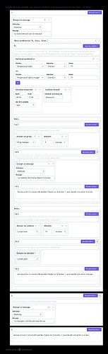

I note here a few points that I plan to change in a v2 of these mockups :
  • rename the action « Condition ‹ If… Then… Else… › » to « Conditional blocks ‹ If… Then… Else… › », because I think that’s more what we’re adding: blocks that execute according to a condition
  • rename the button « Add a condition » to « New condition + », to be consistent with the « New action + » button
  • apply the numbering 1.✓.

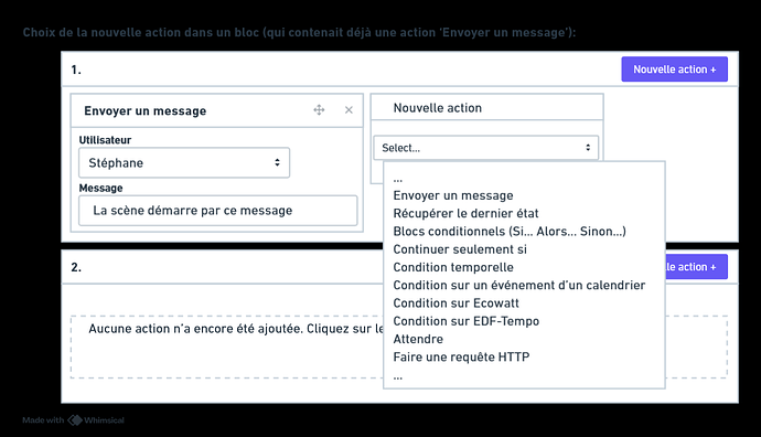

So, mockup v2. La scène finale a changé un peu : un message s’affiche, et si il fait frais dans une des deux pièces et si c’est le matin et si ecowatt (ecowatt) est ok, alors le radiateur s’allume et un message le confirme 5 minutes après. Et

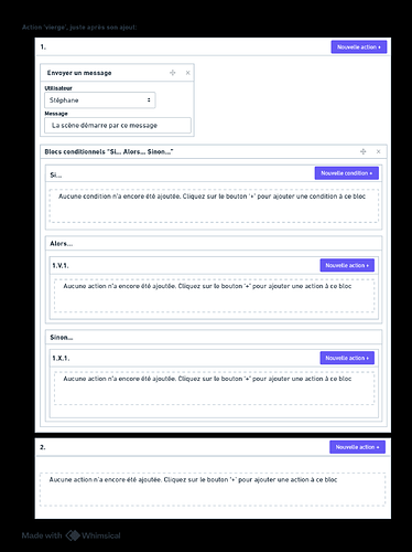

Step 1: an action already exists, we’re about to add an action « Conditional Blocks » in the same block
Step 2: The « Conditional Blocks » action has just been added; it is empty, including the « If… » section (unlike the v1 mockup)

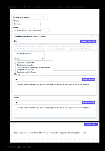

Step 3: A click on « New condition » displays the condition which we choose among the 5 existing ones
Step 4: The complete scene, where you can see the conditions combining. I didn’t keep the specific title « Continue in the Then block… only if »

  • When adding a new action, the dropdown is a bit messy. I think it deserves sorting (in particular to group the « Condition … » items, or the « Send… » ones)

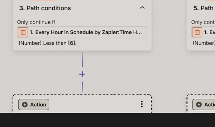

What would be nice is to have a plus button between the action blocks like Zapier does
Here in the mockup, have a plus between action block 1 and action block 2.
For slightly long scenes, this would allow adding an action block anywhere in the scene.

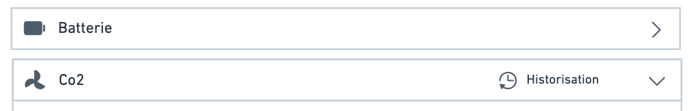

For the « collapse » button, I think it’s better to do like I did in the MQTT integration:
You can use the cross; it’s lighter for this already quite busy interface!
