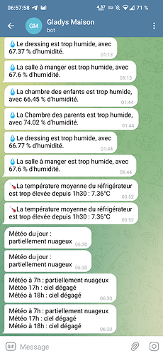

Since the last update (I guess) my scenes seem to be running twice.
Any idea what could be causing that?

Well, everything seems to have returned to normal after 6:30, without any action on my part. To be continued.
By any chance didn’t you have 2 Gladys containers running at the same time? That would explain the double execution.
I was just about to update this thread accordingly. I have a second instance running in parallel that is the cause, and generally Telegram prevents two concurrent accesses to the API.
But not this time. I removed the token from my test instance (I had already removed the Gladys Plus part).
