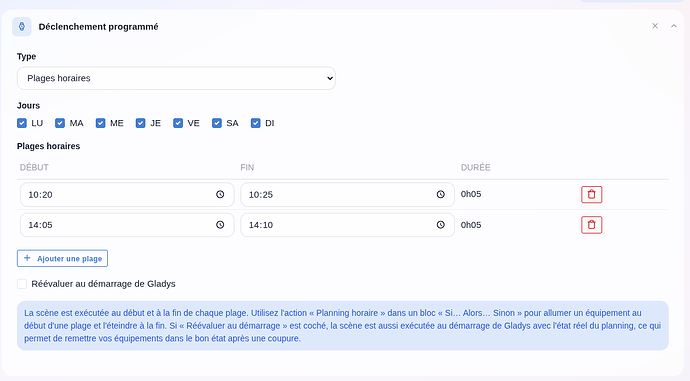

This PR adds a new type of scheduled trigger, « Time Slots », which allows
you to put an entire schedule in a single scene.
How it works
In the trigger, you add as many time slots as you want (a start time, an end
time) and you choose the days of the week concerned. The scene is executed
at the start and end of each time slot.

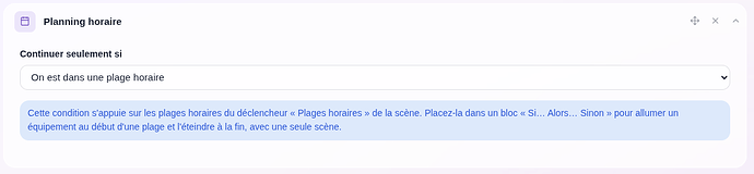

Then, you add the action « Time Slot Schedule » in an « If… Then… Else »
block:
  • Then → we are in a time slot: you turn it on
  • Else → we are outside: you turn it off
One scene, one device, and the schedule you want.
Recovery after a power outage. That’s the feature I find the most useful.
Tasks are scheduled for the future only: if Gladys is stopped at the moment a
slot starts or ends, that moment is never caught up. In practice, a pool pump
cut off by a power outage would stay off until the end of the slot — or worse,
a pump left on would keep running long after the end.
There is therefore a box « Re-evaluate on startup ». If checked, the scene is
run once at Gladys startup with the actual state of the schedule (in a slot or
not), and it’s the scene that puts the device back in the correct state. Gladys
doesn’t know which device you are controlling: rather than guessing, it gives
you back control.
