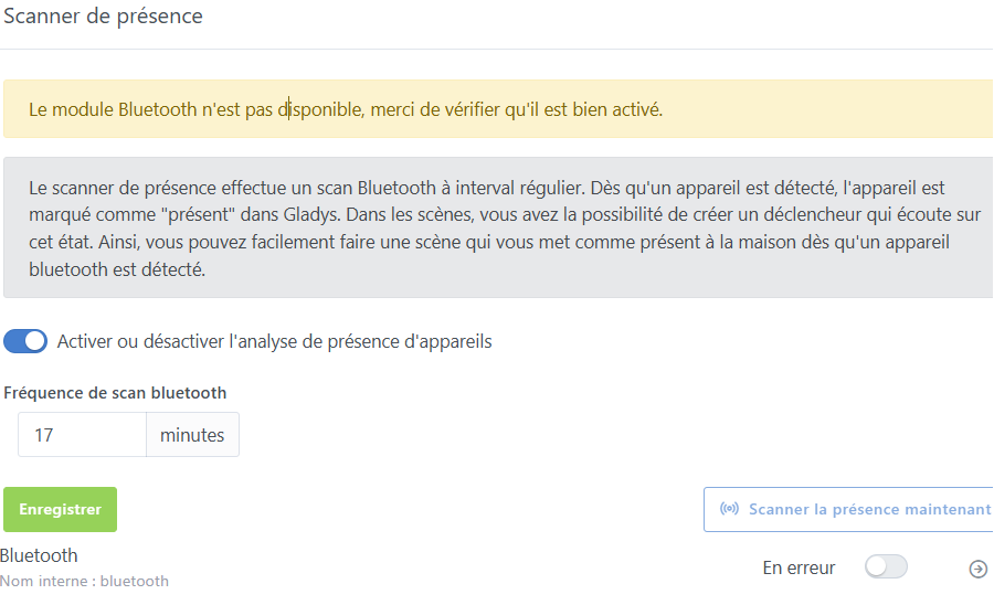

\nHello,\nI have noticed that the Bluetooth service was showing an error but do not know how to restore it.\nI would welcome any information and thank you for your feedback.\n\n
Same for me, I think there has been a regression recently (ping @pierre-gilles)

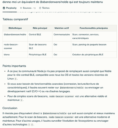

Unfortunately, this integration relies on a dependency that hasn’t been maintained for several years.

@pierre-gilles some VERY quick pointers :
Well, good news, updating @abandonware/noble fixes the issue (at least locally)
