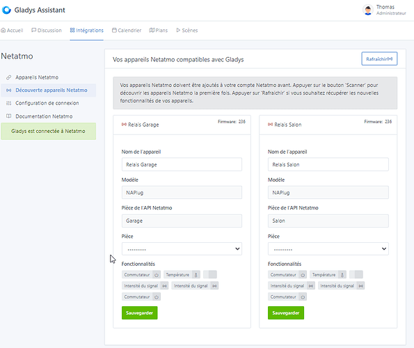

Small mockups of my progress in terms of discovery and device page, could you tell me what you think:
1st discovery:

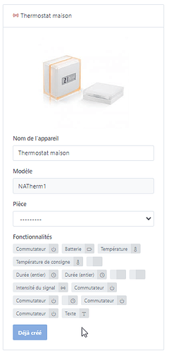

Once saved (button becomes non-clickable and ‹ Already created ›):
When returning to the page (the devices already created no longer appear but will reappear in case of an update on the Netatmo side (the devices are linked to rooms; they will need to be updated if, for example, a room valve is changed - later ^^)

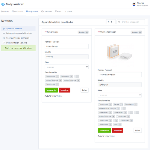

View of devices:

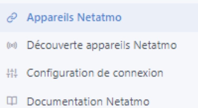

Just for consistency, the labels should be changed:
  1. Remove ‹ Netatmo › after ‹ devices ›
  2. Remove ‹ devices › after ‹ discovery ›
  3. Remove ‹ connection ›
See:

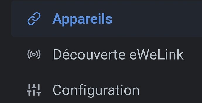

![Screenshot_20231203_141626_Chrome|630x500](upload://1hURrFjxNuJKqtefwEIKFsdJMuL.jpeg
Netatmo documentation at the end.
Very nice.
For the documentation, use what I did for the Sonos integration.

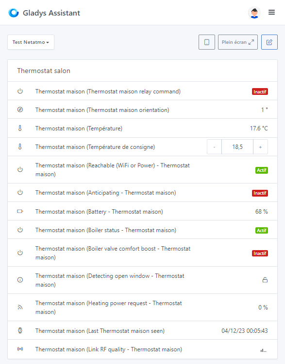

Thanks for your initial feedback. I fixed the menus. Below is the new visual, as well as the dashboard.
However, I still have an unsolvable bug for the moment: I don’t have all 16 features accessible in the Dashboard editor. But I can’t find the subtlety ^^ Especially since the category/type are the same as other ones present!!
![image|690x452](upload://9Wc3d4c2drS5WND
Weird! Are you sure they’re the same (category/type/read_only)?
Yep ^^ but we can start from an assumption => I must have messed up somewhere ^^ I’ll investigate a bit more this weekend ^^
It seems like you’re missing 2 « heure » features on your dashboard, 2 out of 3… didn’t you simply forget to add them to your widget?
That’s exactly the problem ^^ they are not selectable because they don’t appear in the selection list ^^
The 3rd one is my fault ^^ it’s the setpoint mode (manual, frost-protection, …) selectable (so not yet developed).
Great, I have the answer!!^^
These two features are normally controllable. You can define a start and an end for manual heating…
So, what do you think? Should I,
So I agree with what @pierre-gilles is asking: if they’re not read-only, but their value can be modified, it’s possible that the « time editor » widget hasn’t been developed on the dashboard yet :slight_smile:
I recommend doing the dashboard widget development in a separate PR, because this development is common to all Gladys, not just the Netatmo service.
Now, I think you can leave it as it is — we don’t see them on the dashboard because they’re not controllable… for the moment… is it really a big deal?
Indeed!!
Not a problem at all since we can still control the setpoint temperature, there is a default value at 3:00.
For the mode as well, when we control the setpoint temperature, we change the mode on the backend directly to « manual » (the Netatmo API requires that we send it) — we will just not be able to control the return to « program » or « schedul » for the moment.
So I’m not dealing with it for now!!
Thanks for the answers!!
Perfect :+1: Better for the PR to be as small as possible :slight_smile:
