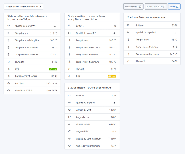

We’re making progress on the weather station:
Rain gauge done and we’re all set to move on!

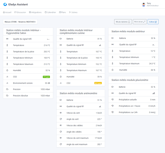

All good for the weather station :
@pierre-gilles could you review the 6 PRs (I made them independent but the order is important, at least for PRs 1 and 2).
And tell me which you prefer, I have a branch that integrates all six of these devices. It can make small fixes applied incrementally easier and especially the review (46 files on the single branch versus 6 PRs × ~20 files when split since most files are affected in each PR).
@PhilippeMA, if you’re up for testing the whole weather station: docker pull terdious/gladys:netatmo-features-nrv-weather
