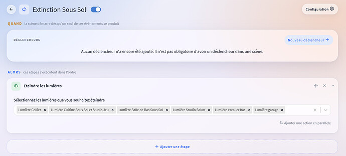

@Zenfull could you put a screenshot of the action you are using in the scene?
I also had an issue with a double switch (zwave) and I think I had to take Control a device to access the 2 commands.
just one action to turn off the lights
I just tested your solution and indeed, performing a simple device check is effective for turning off the two lights separately. Who knew? Thanks!
