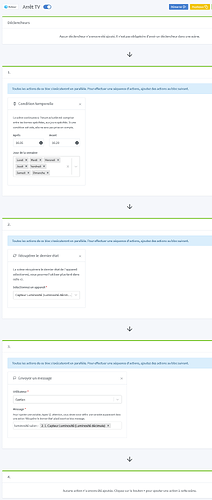

I’m trying to use a time condition to create a scene that disables my TV’s standby between 00:00 and 06:00 every day.
I’ve simplified it as much as possible because I can’t get the time condition to work.
For now, I want to send myself the value measured by a sensor in a message, but nothing happens.
When I tested, it was during the time window.
Since then, I’ve been looking for answers on the forum and in the documentation, to no avail.
Maybe I’m doing it wrong.
Thanks in advance for your help.

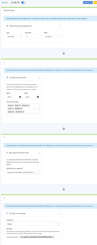

I tested with a trigger:
If I set a trigger at a certain time and the 2nd condition (luminosity < threshold) is not met because the light is still on, the scene will not be triggered after that time.
I could set a trigger at intervals every 10 minutes, but that overloads Gladys’ operation.
Adding a time condition to check that the time window has been reached isn’t ideal.
Not using a trigger seems more sensible to me.

I just tested a trigger every 2 minutes that checks whether we’re within the desired time range. (You need a time range large enough to be sure to fall into it, or an interval small enough…)
It then executes the action.
I thought that the time condition itself would check whether we were inside the time range, but that’s not the case.
So you need an interval trigger that checks if we’re within the time range and thus executes the action each time it is triggered within that range.

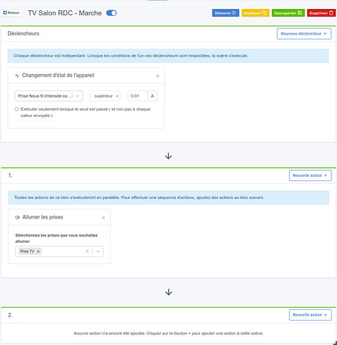

So for you to turn off
trigger: change of state of the plug
plug below 0.01 A
time condition between 00:00 and 05:59
→ turn off the plug
Turn on the TV
trigger: scheduled
at 6:00 turn on the TV plug

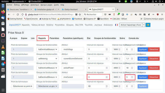

Note: I just had to modify the plug parameters in Zigbee2MQTT
because it only sent values every 7 minutes minimum; for starting the TV that wasn’t practical.
