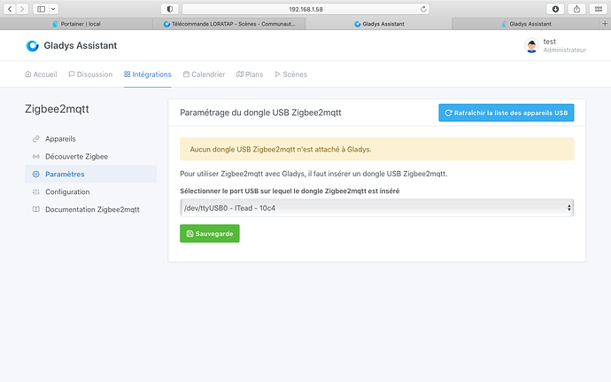

Attempt to install the test image on a new Raspberry Pi, but it fails when saving the USB dongle.
The dongle backup isn’t working, so the associated containers are not being deployed.
Could this be caused by my Docker deployment command?

Which version of the OS?
Here is my version information:

Try adding --cgroupns host to your docker command (since you’re on Bullseye)
For info, we launch the container like this on the Pi image.
I just tested it, it works!
You’re a genius!!
And the remote too!!
