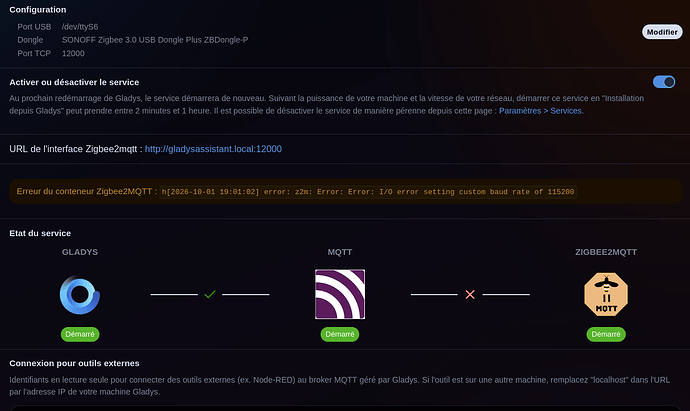

The installation goes well at least at the beginning then boom!
Apparently everything is « started »
But there is this message:
Zigbee2MQTT container error: h[2026-10-01 19:01:02] error: z2m: Error: Error: I/O error setting custom baud rate of 115200
Is this a speed (baud rate) issue?
Of course I restarted the server hosting Gladys several times.
Thanks in advance…
Hello. You need to choose the ZBdongle-E dongle (you chose the P in the list).
In Configuration > Dongle
Thanks for the suggestion.
The error message is no longer the same.
Zigbee2MQTT container error: G[2026-10-01 20:39:32] error: z2m: Error: Failure to connect
Strangely, the proposed devices are changing…
