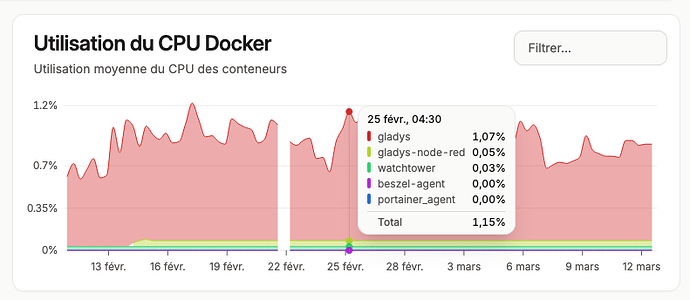

you must have something wrong because on my side I don’t have any issues with the CPU spiking since version 4.70 (or even before):
And I have Zigbee, Node-RED, Z-Wave and scenes running on Gladys.
What’s your hardware setup to run Gladys? (CPU, RAM, HDD/SSD, etc.)

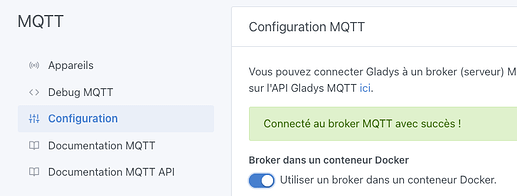

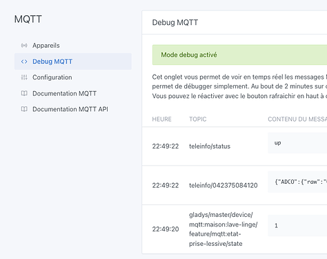

However, regarding Gladys’s MQTT integration, do you use the internal integration?
Then, what does the debug page say?
If you use MQTT Explorer (for example) to connect to the MQTT broker, do any of your RPi information appear?

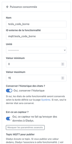

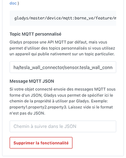

Another point, how did you configure your devices in the MQTT integration?
From what I see in the error message, one (or several?) device is not found/recognized; you should check with MQTT Explorer whether it is visible and whether its configuration is still correct in Gladys’s MQTT integration.
