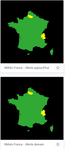

The final result:

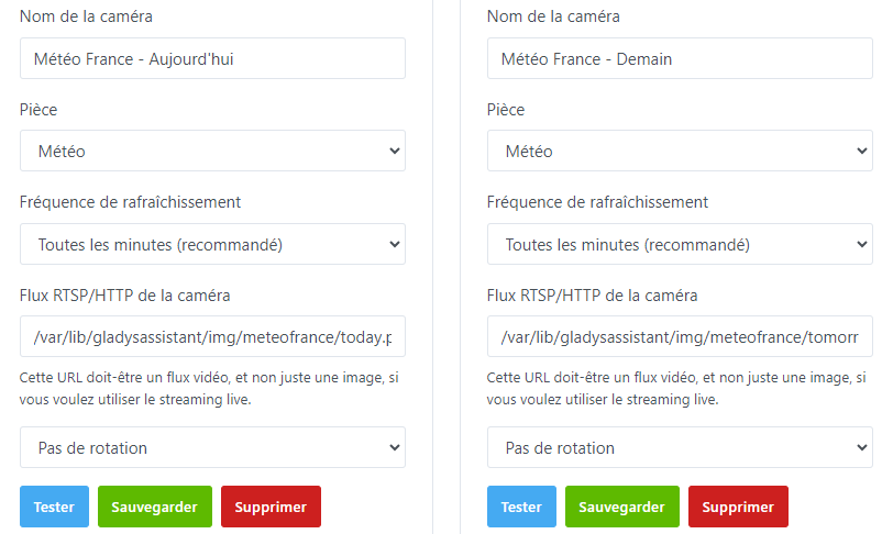

Then create the 2 cameras like this:
You can then display them on the Gladys interface
I haven’t managed to get the white background but if you have a lead I’m open to suggestions :slight_smile:
