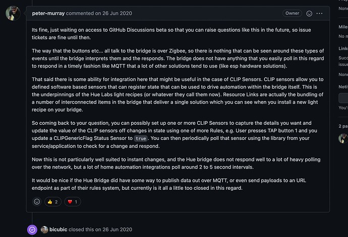

Upon searching, indeed, apart from via Zigbee, the Hue bridge does not allow receiving an alert (via HTTP, MQTT, or otherwise) when a Hue sensor sends a value. Therefore, integration will never be possible via the Philips Hue integration, only via the Zigbee2mqtt integration ![]()
