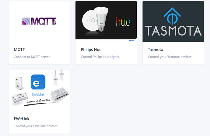

  1. I find that the image is quite heavy compared to the others
  2. Some titles are missing, and perhaps increase the height and center the « no devices found ».

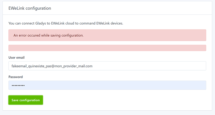

  3. When you make a mistake on your login/password, you have display problems.

Small survey for the choice of the image:
  • I vote for image 1
  • I vote for image 2
0 votant

I still have the double error message problem when I enter the wrong credentials.
The image is still there, but I see that you have launched a survey.
Why not:
