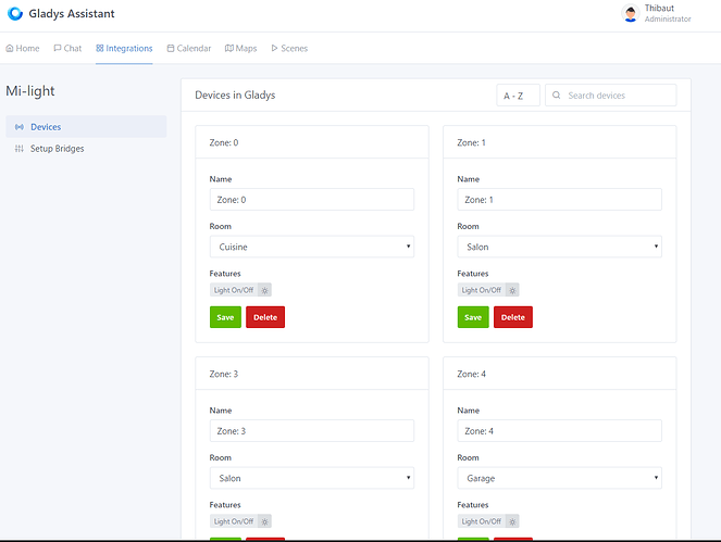

I’m working on developing the milight service. It will probably take some time as I’m not an expert in development, but I’m very motivated :wink:. For now, I can retrieve the gateway, include it in Gladys, and create the 4 Milight zones as devices.
Next step, send the command to turn the lights on/off.
Is anyone using milights?
Some previews

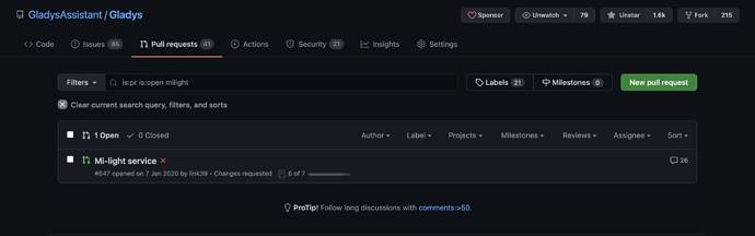

a PR for the mi-light service:
https://github.com/GladysAssistant/Gladys/pull/647
I’m not a dev so be indulgent… and I’m open to all remarks and advice :wink:
I was heavily inspired by the hue module to understand the dev logic and I admit that some elements still escape me, especially for the interactions between UI and server.

There are several comments from @AlexTrovato and myself on the PR in March 2020, but I think @link39 is no longer available and there have been no changes since.
If anyone has some milight and wants to pick up the torch on the PR :slight_smile:
