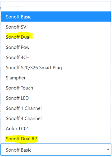

Bon, I just took some time to install your version @AlexTrovato.
I can’t find my Sonoff Dual, neither in automatic nor in manual addition, it’s not in the list.
You have the basic, S26, and POW on the list? Do you see any others?
Didn’t you integrate the Dual R2 based on what I sent you?
Yes yes:
Are you sure you have the right Docker image?
Okay, I fixed it, it’s good, I restarted my Rasp, configured the MQTT service, and I manually added the Sonoff Dual R2, it works perfectly.
