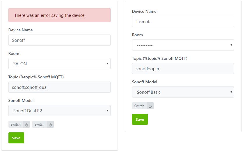

Ok, I made some visual changes and I think I fixed the bug.
The new image is generated, waiting for your feedback :wink:
Yes, it’s much better.
  • The detection of the 3 Sonoff devices works
  • I can save the Sonoff devices, I no longer have an error message
  • I can add them to the dashboard
  • For the dual, I have the same name twice (it would be possible to edit the name for the 2 channels)

This should not be the case, and I have added the possibility to edit the name of the features (Edit on the feature in the service).
Yes, we can edit it, but there are two outputs instead of one.
On the dashboard, I have two Sonoff Dual entries.

Oh, it seems I made it worse!!! I’m disappointed, I’ll fix it as soon as possible.
The new image is available.
Warning, I took the opportunity to rename Sonoff to Tasmota. A migration script should make this renaming invisible in the database, but nothing is foolproof.
In the worst case, you will need to delete and recreate your device.
