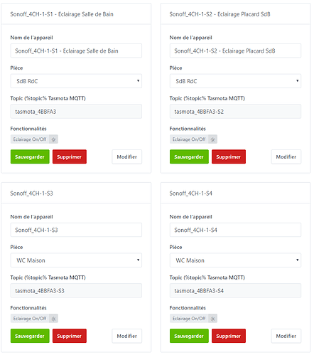

I don’t know if others have already managed to get an interface with Sonoff devices with multiple relays and to use them via scenarios, but since I needed these two points for my use, if anyone is interested, I can describe the manipulation to be done if you wish. This is a direct DB manipulation at the moment where I duplicate in the t_device table the desired multi-relay device with an ID incremented by 1 and a modification of the selector and the external_id. Then, all that’s left is to modify the device_id in the t_device_feature table according to those newly created. I took the opportunity to modify the category of all the Sonoff devices I want to control in the scenes to light instead of switch. This being said, this last point is only useful until the integration of other controls than « light » in the Scenes.
View of Tasmota Devices - 1 relay 4CH:
GIF Sonoff_4CH functional after device and device_feature changes in DB:
Sonoff_4CH New device
Sonoff_4CH Light Scene

      Currently, all the switches are integrated into 1 single device. Therefore, there is no possibility to put them in separate rooms. Would it be possible to create distinct devices at the integration of a Sonoff with multiple Switches? This would also solve the problem of the names displayed on the dashboard. It would be enough to integrate them by keeping the current device_feature but when in the mqtt message we see:
