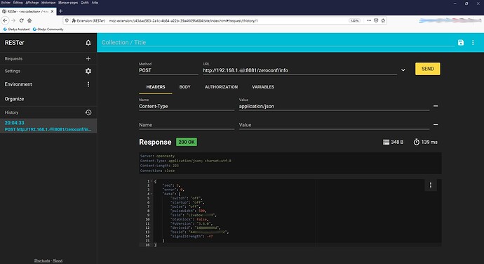

I can join the module thanks to the RESTer (REST-API) extension:
http://192.168.1.XX:8081/zeroconf/info
Could this allow flashing them to be recognized in Gladys?
