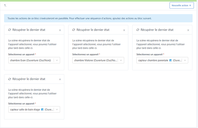

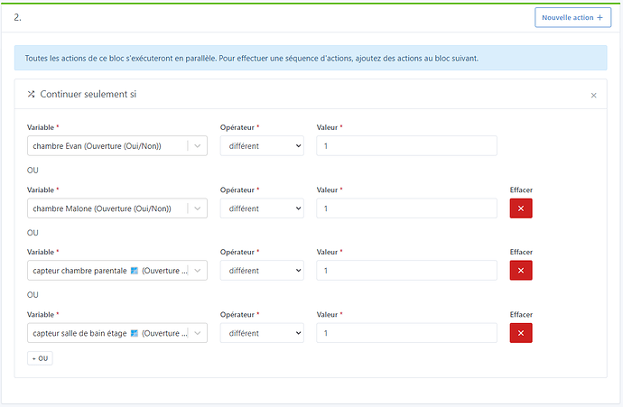

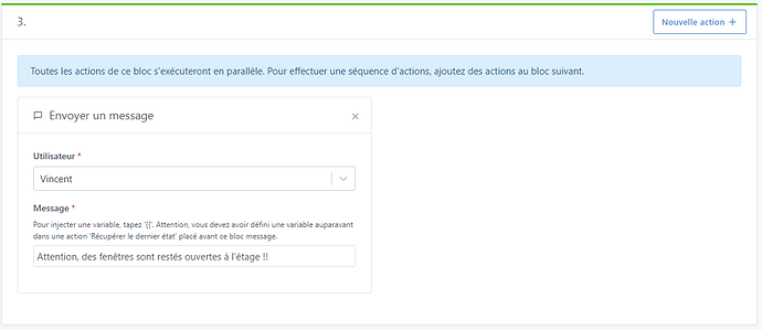

Here’s what I have next:
A Zigbee push button in the entrance that you click when you leave?
Do you have a style like a SNZB-01 from Sonoff?
https://www.domadoo.fr/fr/peripheriques/5259-sonoff-interrupteur-sans-fil-zigbee-30-snzb-01.html?domid=17
Yes for example :slight_smile: You click on it when you want to leave, and in Gladys you create a trigger on that click.
It’s like a « home lock » mode for you.
