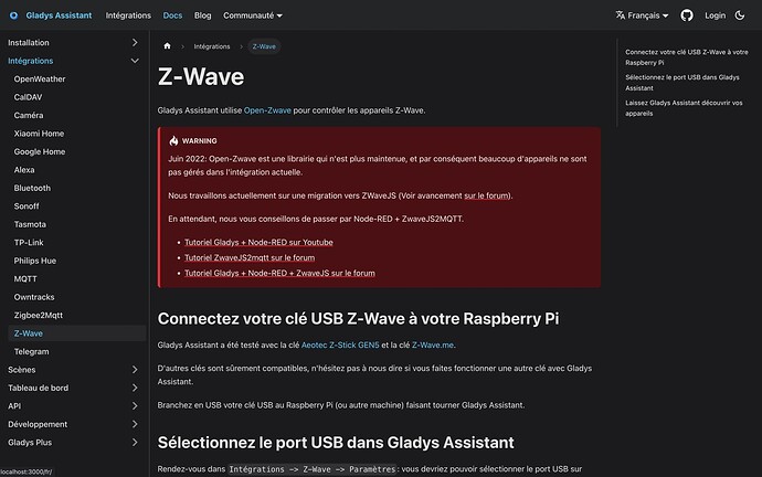

It might be worth mentioning this in the documentation :warning:
https://gladysassistant.com/fr/docs/integrations/zwave/
So I’ll go back to Domotic
Hello @Doudy, indeed I confirm, currently the Z-Wave integration in Gladys is based on a library that is no longer maintained. We’re migrating to ZWaveJS, but it’s a lot of work and there is less enthusiasm for Z-Wave than in the past (many people use Zigbee now), and so on the developer side it’s less common to have developers motivated by Z-Wave ^^
In the meantime, using ZWaveJS2Mqtt + Node-RED + Gladys is the best solution!
I added a note in the documentation, so it’s clearer :slight_smile:
