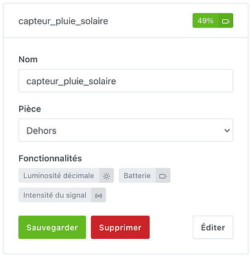

[Z2M] Adding features for TUYA RB-SRAIN01

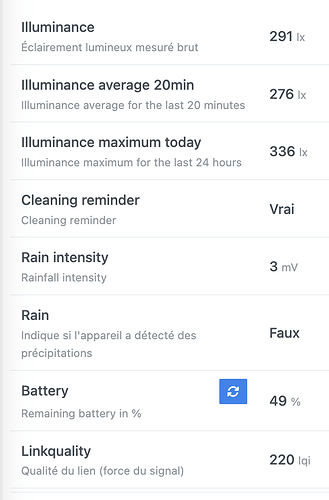

I’ve just acquired this charming flower and unfortunately a few features are missing.
Here are the details:
  "battery": 49,
  "cleaning_reminder": true,
  "illuminance": 12,
  "illuminance_average_20min": 262,
  "illuminance_maximum_today": 336,
  "last_seen": "2025-02-18T20:15:26+00:00",
  "linkquality": 220,
  "rain": false,
  "rain_intensity": 3
Thank you in advance :slight_smile:
Gladys doesn’t integrate all features of every device (especially the more exotic ones). Moreover, some concepts don’t exist at all (like the presence of rain).
Which features do you really need in Gladys? Rain and Rain Intensity?
Hi @cicoub13
illuminance_average_20min and illuminance_maximum_today could be interesting for stats if you can integrate them easily but it’s not my priority (e.g., I don’t have solar panels to do analyses between illuminace_max and production_max).
rain and rain_intensity would be the two to have absolutely in addition to the illuminance we already have.

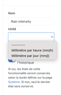

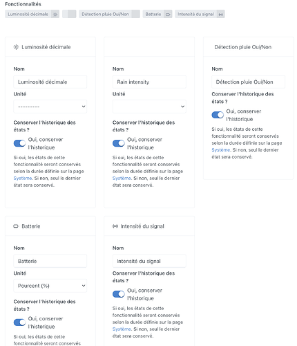

Test Docker container launched with cicoub13/gladys:tuya-rain, and here are the results.
It seems the French translation of Rain intensity is missing:

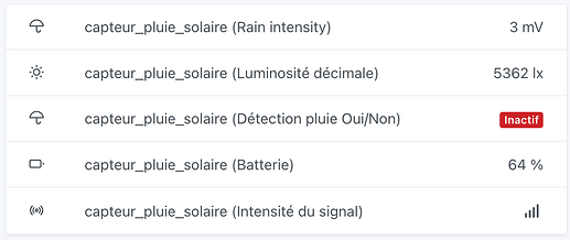

For Rain intensity, the unit should be mV:
For Illuminance, we can have Lux by default instead of the -----:
And icons are indeed missing as @pierre-gilles indicated:

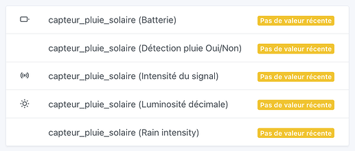

For now I’m waiting for feedback but I wonder if it’s not too far off …
It was indeed a bit too far, here with some values:

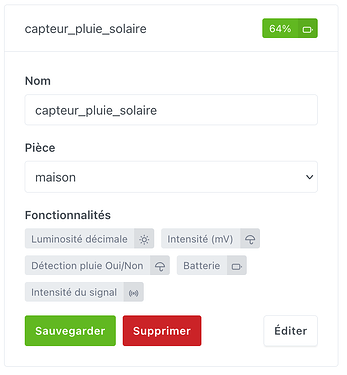

So I found why it wasn’t changing.
In fact, even after deleting the image, when I ran docker-compose it would bring back the old image…
I had to pull the new image first and then run docker-compose.
And everything is fine, thanks @cicoub13 :
If I dared, I’d ask you to have the units in lux by default for brightness :slight_smile:
