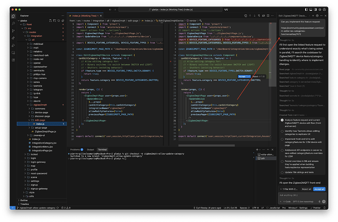

Hello everyone
I had fun assigning this task to Windsurf, with GPT-5 (low reasoning); without explaining anything, I just sent the link to this thread:
And it produced a really perfect implementation for me:
master â zigbee2mqtt-allow-update-category
ouvert 10:07AM - 11 Sep 25 UTC

Fix https://community.gladysassistant.com/t/z2m-editer-les-categories-fonctionnalites/7472
Well, itâs a specific case of development thatâs easy to implement but lengthy to test.
What took me the most time was testing the result, but I was still impressed by the quality of the implementation!

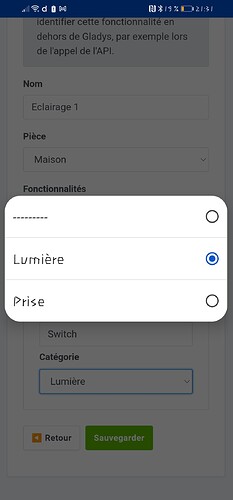

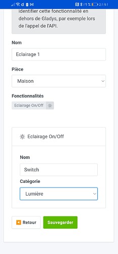

So, I tested it live on my test hardware, and it works very well:
Iâll keep you posted when itâs available
