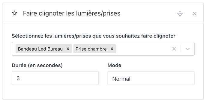

Make an outlet blink
Following the development of this feature for lights (and at the request to develop the same for plugs), here is a test image
docker pull cicoub13/gladys:blink-electric-plug
:warning: This is a test image, run it at your own risk. Here is the documentation for this type of image.
We chose to handle both types (lights/plugs) in the same action type.

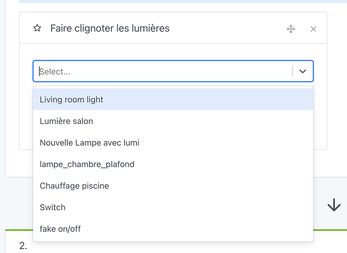

@cicoub13 I just tested it, it works fine for me!
Just a little UX feedback, since the lists of lights and outlets are concatenated, the order is lost and so it can be hard to find your way around:
Maybe we could add sorting to the table so it’s properly ordered?
See review: gladys (Gladys Anne) · GitHub
Indeed, excellent point.
Other than that, it’s running smoothly!
Thanks @cicoub13!
Change made, PR and Docker image up to date :white_check_mark:
Thanks @cicoub13 for the fixes, it’s good for me!
