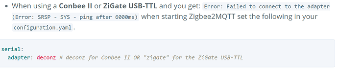

During a quick trip to mainland France, I picked up a zigate v2 usb dongle… and then discovered that there were some issues with zigbee2mqtt… Specifically, the following parameter needs to be added to the configuration.yaml file:
Problem is, I don’t know how the configuration.yaml file is generated during integration and whether it can be modified directly via docker cp for example?
