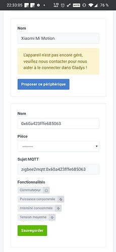

In any case, nothing is displayed in Gladys regarding my outlet, which still returns the status, voltage, and instantaneous power.
Another bug: when I use the mobile interface, the scan doesn’t work and displays an error.
If I check « show PC version Â» from the same mobile browser, it works again.

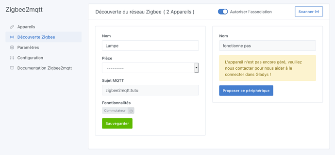

I propose the following interface. The Suggest this device button allows opening an issue on Github with the brand + model. This will allow us to have all the information to add it to Gladys.
Let me know what you think of it.
It’s approved @cicoub13, clean!
Great that you like my idea :slight_smile:
Your proposal is very good, exactly what I would have liked to see as a user.
For the sentence, I suggest: « This device is not yet supported, but contact us to help us connect it in Gladys Â».
