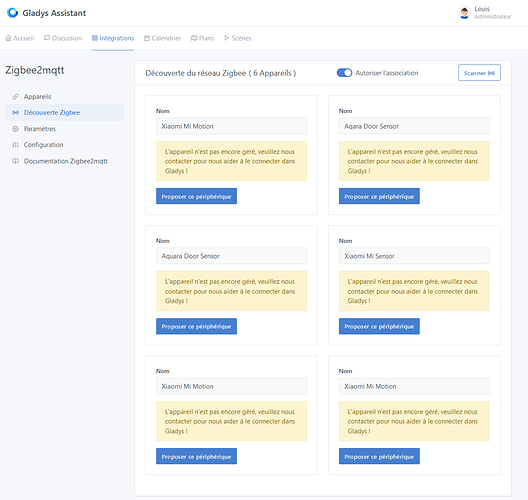

This morning, impossible to integrate or see the outlet (updated image) and therefore to add it:
On the log side, I have a few errors.
1. All presence sensors RTCGQ11LM
These sensors are however functional and configured in Gladys.

Still nothing in Gladys’ scan result, although Zigbee2Mqtt returns my devices correctly…

The scan now works, but I can’t click on « Add » (« An error occurred during saving ») for my TuYa plug.

[EDIT] The scan no longer works with this morning’s image. Impossible to see my motion sensor or my TuYa outlet in Gladys, but I can see it in Zigbee2Mqtt.
