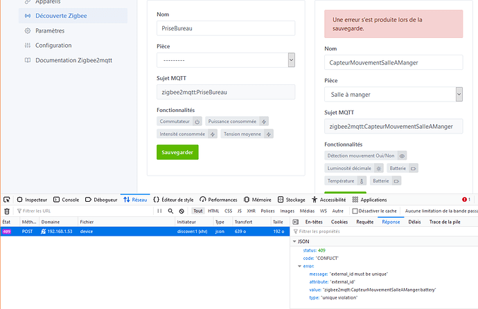

Bug when adding devices
Bug details: When I add a new device, I regularly get the error « An error occurred during saving ».
Steps to reproduce the bug:
  1. Add a new device with its default name
  2. Delete it
  3. Add it again with its default name
  4. BOOM! Error.
Fixes:
  1. During the 2nd addition, rename the name with « TEST » at the end (for example)
  2. Add the device
  3. Rename the device with its default name (it works)
Recommendations:
  • When deleting a device, make sure to remove all entries in the database to allow it to be added again with the same name
  • If a device with the same name exists, display a more explicit error « A device with the same name already exists » for example.

On the bug side, I tried to get more information about my bug when adding equipment, but I don’t have anything more despite the verbose mode logs :frowning:
When I recreate the bug, nothing is displayed on Gladys. I only have the API in the browser that responds:
« External ID must be unique » « zigbee2mqtt:CapteurMouvementSalleAManger:battery »
However, I had renamed this device before adding it, to « CapteurMouvementSalleAMangerunique ». So in the front end, the renaming does not seem correct at all levels.

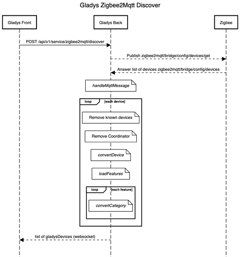

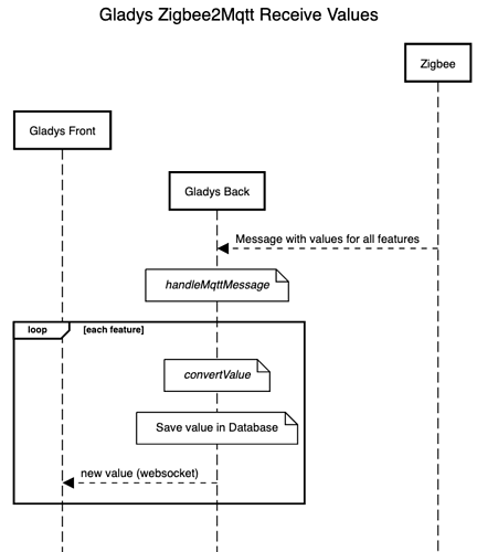

Here’s the principle:
  • during the Discover phase, all feature categories are detected with a conversion in convertCategory (for those that don’t have the same name between Gladys and Zigbee). If there are issues with incompatible devices or missing features, that’s where they occur
  • when messages with values are received, it works like this
  • when values are modified, only the ON/OFF state is handled
I’ll let you look at the mentioned files in more detail if you want to go through the entire process.
But we’ll review it together :slight_smile:
Thanks, that’s very clear! I like the diagrams for that :slight_smile:
By the way, which « mentioned files » are you referring to?
I can find some via the API calls, but for the others (the loop ones, for example)?
Thanks for the diagram @cicoub13, it’s really clean to have this kind of diagram for new arrivals afterwards :slight_smile:
