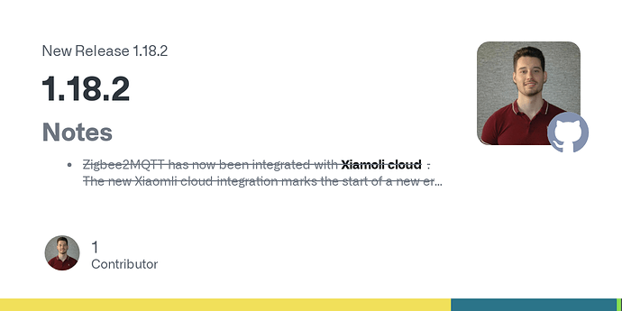

For information, the latest release of the « Zigbee2Mqtt » component we use, brings a native (and mandatory) integration with the Xiamomi cloud:
I was scared, I read, then I understood :egg: :chocolate_bar: :chicken:
:rofl: :rofl:
I still searched for 15 minutes on the internet, restored a backup of the Zigbee folder, and then I understood!:rofl: :rofl:
I understood only after your message :joy: I didn’t have it, I was crazy
I didn’t get it at all, WTF!! I even thought damn, they didn’t even bother with the name :stuck_out_tongue_winking_eye:

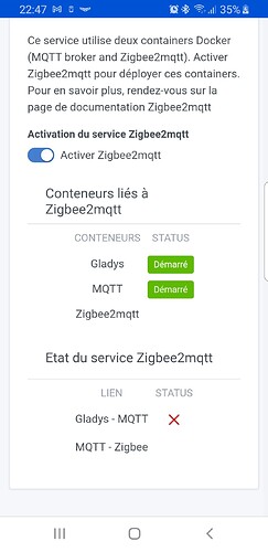

After connecting my stick, here’s what I get. But it doesn’t progress any further.

Hello. Can you try disabling/enabling the service? If that doesn’t work, you’ll need to check the logs of the containers gladys-z2m-mqtt and gladys-z2m-zigbee2mqtt.
I see a device 0x000b57fffe4960e8 but without additional information. Are you sure the bulb is properly associated?
You can go to your Raspberry Pi’s IP address by adding :8080 as the port to access the Zigbee interface.
It’s my fault, I hadn’t deployed 4.2.1 :slight_smile: It’s all good now!
