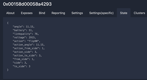

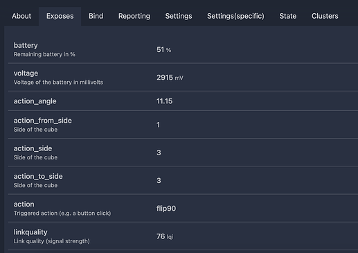

Another issue with the XIAOMI cube
On Gladys side, it is still considered as a button click:
While on port 8080 we have:
Problem on Gladys side or integration?

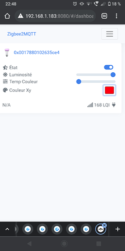

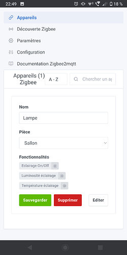

Is the color for the bulbs well managed in Gladys?
I have a Philips Hue bulb that is integrated via Zigbee2MQTT, we can manage the switching on and off and manage the intensity but not the color.
While in the portal on 8080 the bulb is well recognized as managing the color and it works.
So, I’m answering myself.
