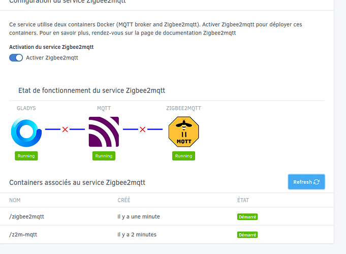

I had to improvise to get the 3 containers running, impossible to have the zigbee2mqtt container (I had to remove the passwords from the mqtt config to use my old container, etc.)
So normally it’s fine as the status side
However, in the logs:
Edit: it finally worked

Just a quick question, I have a RPi running with the official Gladys image (v4)
Can I use your image in parallel on the same RPi without creating conflicts (by changing the ports for the UI of course)? Or would it be wise to do tests on a dedicated card for this?
You can change the port and the name of the DB

At the top @VonOx! I’ll do that and I’ll give you some feedback quickly with my Xiaomi equipment (door opening, vibration, brightness, push button, etc..)
Well, I get this…
docker logs gladys-zigbee2mqtt
pi@gladys:~ $ docker logs gladys-zigbee2mqtt

2020-11-16T12:09:11+0100 <warn> connect.js:32 (MqttClient.<anonymous>) Error while connecting to MQTT - Error: Connection refused: Not authorized
2020-11-16T12:09:16+0100 <warn> connect.js:32 (MqttClient.<anonymous>) Error while connecting to MQTT - Error: Connection refused: Not authorized
2020-11-16T12:09:21+0100 <warn> connect.js:32 (MqttClient.<anonymous>) Error while connecting to MQTT - Error: Connection refused: Not authorized
2020-11-16T12:09:26+0100 <warn> connect.js:32 (MqttClient.<anonymous>) Error while connecting to MQTT - Error: Connection refused: Not authorized
2020-11-16T12:09:31+0100 <warn> connect.js:32 (MqttClient.<anonymous>) Error while connecting to MQTT - Error: Connection refused: Not authorized
I know why
Execute these 2 commands:
docker restart z2m-mqtt
docker restart zigbee2mqtt
Then check again in Gladys
Everything is green! Thanks @VonOx!
