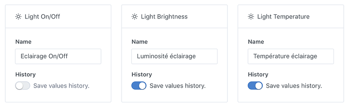

We should add a toggle « Save value history » in the Zigbee2mqtt service UI, which corresponds to the « keep_history » attribute in the « device_feature » table.
See code: Gladys/server/models/device_feature.js at master · GladysAssistant/Gladys · GitHub
Do you want to take on the development @JeuFore? :slight_smile:
@cicoub13 can help you understand the structure of the Zigbee2mqtt integration if you need help, he’s the one who worked the most on it :slight_smile:

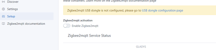

@cicoub13 I had a power outage
After the restart, no more z2m / mqtt
2021-06-22T14:20:11+0200 <warn> service.start.js:44 (Service.start) Unable to start service zigbee2mqtt Error: (HTTP code 301) unexpected -
    at /src/server/node_modules/docker-modem/lib/modem.js:301:17
    at getCause (/src/server/node_modules/docker-modem/lib/modem.js:331:7)
    at Modem.buildPayload (/src/server/node_modules/docker-modem/lib/modem.js:300:5)
    at IncomingMessage.<anonymous> (/src/server/node_modules/docker-modem/lib/modem.js:275:14)
    at IncomingMessage.emit (events.js:388:22)
    at endReadableNT (internal/streams/readable.js:1336:12)
    at processTicksAndRejections (internal/process/task_queues.js:82:21) {
  reason: undefined,
  statusCode: 301,
  json: <Buffer >
2021-06-22T14:20:11+0200 <error> index.js:20 (process.<anonymous>) uncaughtException catched: uncaughtException
2021-06-22T14:20:11+0200 <error> index.js:21 (process.<anonymous>) Error: getaddrinfo ENOTFOUND containers
    at GetAddrInfoReqWrap.onlookup [as oncomplete] (dns.js:67:26) {
  errno: -3008,
  code: 'ENOTFOUND',
  syscall: 'getaddrinfo',
  hostname: 'containers'
Everything is okay with Docker
Home Assistant has no connection issues with the same MQTT server.
I don’t understand why I ended up in this unstable state.
I noticed this because the « Temperature in room » box had no recent data.
Unable to configure the service (the dongle is configured)
Lots of information, but if you need anything else, don’t hesitate.
EDIT: I had to restart my server (physical), it fixed my issue, it’s probably the dockerode library that messed up.

So, I started looking into the keep_history feature on Zigbee2mqtt.
I’ll test it this weekend to see if it works in real conditions, as I’m not at home right now.
Hello. The temperature of the bulbs is now managed (with a nice slider).
Can you update the image cicoub13/gladys:dev-zigbee2mqtt and test again (spoiler, I tested and it works great)? It should arrive soon in the version available to everyone :rocket:
Okay, I’m testing the image this weekend. By the way, a quick question, does anyone have problems creating Zigbee containers via Gladys :thinking:?
