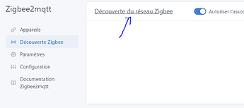

Hey, did anyone find the hidden feature I added for testing?

Is it the nice interface like Zigbee2MqttAssistant? :stuck_out_tongue_winking_eye: (I love it :wink: )
Actually, it’s a frontend that is now integrated into the Zigbee2mqtt service. For testing, it allows you to check the proper pairing of devices, which I find is still quite capricious with Zigbee…
In the long term, I plan to add the network map display directly in Gladys.
Oh well, I couldn’t figure out how to access it :cry:

It’s on the title « network discovery ». It might not work on your config…

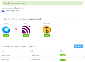

Super, it works! Well, almost ^^
I still have an error between gladys and mqtt but between mqtt and zigbee2mqtt it’s fine =)
I’m putting the logs, I tried to restart both with « docker restart » but still the same:

It displays this in a loop every 30 seconds ^^
Try restarting the 2 containers
Yes, that’s what I did, sorry I didn’t express myself well.

Try restarting the gladys_zeegbee2mqtt container to see.

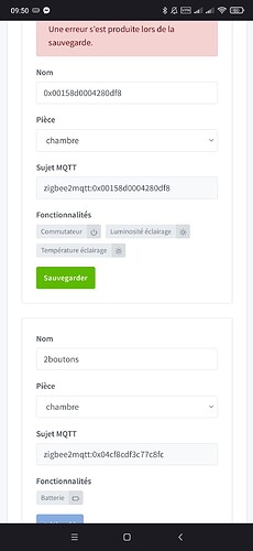

A quick technical question about strange behavior … : I tried to add the following material to Gladys https://fr.aliexpress.com/item/4000389424476.html?spm=a2g0s.9042311.0.0.23c26c37MUUbER
The issue is that when I scan, it shows two devices: one with the switch functions and the other with only the battery.
When I tried to add it to Gladys, I got the red error message.
However, I was able to add the one that gives the battery information.
How can I debug this?
