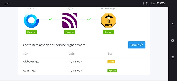

So I noticed something strange:
zigbee2mqtt is « running » but stopped… :thinking:
Is the container running?
docker ps -a
No, it’s not… That’s exactly why it seems strange to me.
Well, I ended up removing everything / restarting everything.
